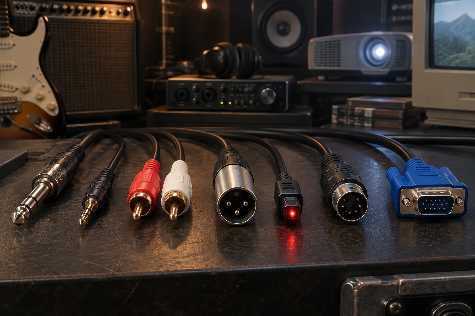

How-To Geek recently ran down seven of them: the 1/4-inch jack, the 3.5 mm jack, RCA, XLR, TOSLINK optical, five-pin DIN MIDI and VGA. This piece walks through each one. It also tightens a few claims that were looser than the evidence allows, because "old" doesn't automatically mean "better."

The shared lesson isn't that old beats new. It's that each port survives because it solves a narrow problem cheaply:
| Port | Why it persists | Watch out for |
| 1/4-inch jack | Instruments, studio headphones | TS, TRS and TRRS mismatches |
| 3.5 mm | Simple wired audio | Headset wiring and combo jacks |
| RCA | Analog line-level gear | Input, output and phono labeling |
| XLR | Balanced mics, phantom power | Not every input supplies power |
| TOSLINK | Electrical isolation | PCM and Dolby Digital limits |
| 5-pin DIN MIDI | Instrument control | In, Out and Thru direction |
| VGA | Legacy projectors | Needs an active converter |
