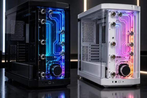

Alphacool's Apex Distro Plate Y70 is built for one case only
In Alphacool's announcement, published by TechPowerUp, the plates have been developed specifically for the Y70 series and replace the front cover of the case. This makes the water-cooling loop not only a functional part of the system, but also a key visual element of the build. The two versions are called Apex Distro Plate Y70 D5/DDC – Black and Apex Distro Plate Y70 D5/DDC – White. Both appear in Alphacool's download center with datasheets and manuals, under article numbers 14726 and 5100189.
A distribution plate, or distro plate, is a flat acrylic block with coolant channels cut into it. It replaces a tangle of separate tubes with fixed paths and ports, and it usually holds the pump as well. Because each plate has to match one case's panel size and mounting points, it only fits that case. The US retailer Performance-PCs spells this out in its listings: the Apex Distro Plate for the Y70 and Y70 Touch infinite is exclusively compatible with this case. A pump is not included in the scope of delivery.
So €319.98 buys the plate and nothing else. You still need to budget for a pump, radiators, CPU and GPU water blocks, fittings, tubing and coolant. The announcement lists no port count, port layout or plate dimensions. Those figures decide whether your planned radiator and block positions line up with the plate's ports, so check the manual before you buy.
Two-piece G1/4 fittings keep threads out of the acrylic
The engineering claim in this release is about the fittings. Alphacool says the chrome-plated G1/4" brass fittings aren't screwed straight into the acrylic. Each fitting comes in two pieces that use an O-ring and lock together during installation. Alphacool says this puts less stress on the acrylic and helps prevent leaks from cracks around the fittings.
This isn't new to the Y70 product. Alphacool used the same approach on its earlier Y60 plate, and a retailer listing for that model says Alphacool avoids the problem of possible leaks due to cracking by screwing the connections directly into the acrylic. The connections are in two parts, have an O-ring and lock against each other of mounting in the acrylic. The Y70 plate carries the same design rationale into a larger case.
The reasoning holds up in general terms. Acrylic is brittle, and a fitting overtightened into threads cut in the acrylic can start cracks from the port. Keep in mind that the leak-prevention benefit is Alphacool's own claim. No independent testing or long-term reliability data for the Y70 plates has been published.
The plates are made of acrylic and have built-in aRGB lighting. Alphacool says they give a clear view of the loop, with the lighting adding accents. The announcement doesn't say how the lighting connects. On the earlier Y60 plate, the lighting can be controlled via a digital aRGB -Header on the mainboard or optionally controlled by Alphacool's Aurora Eiscontrol aRGB controller. The Y70 plate may work the same way, but that's an inference, so check the Y70 manual before planning your header use.
D5 or DDC pump support, plus a €12.98 sealing cap
Alphacool says a newly developed pump mount accepts both D5/VPP and DDC pumps. D5 (sold as VPP by some makers, including Alphacool) and DDC are the two most common pump families in custom loops. They have different physical formats, so a plate that takes only one of them decides which pump you can buy. Supporting both lets you reuse a pump you already own or pick either type for a new build.
The sealing cap goes further. Alphacool says it closes off an unused pump position, so the pump can sit somewhere else in the loop. If you'd rather keep the pump elsewhere in the case, for example in a separate reservoir-and-pump unit, you can still use the plate just for routing coolant. The cap's product name mentions only VPP/D5 pump mounts. The announcement doesn't say whether a DDC-configured mount needs a different blanking part.

The release covers both the standard Hyte Y70 and the Y70 Touch Infinite, and the retailer listings repeat that pairing. It doesn't explain how installation differs between the two cases, or whether swapping the front cover affects anything else on the Touch Infinite model. The Touch Infinite has a built-in display, so that's worth checking directly. Alphacool's Y70 documentation hasn't been reviewed for these details, and nothing here should be read as a claim that every feature of the case is unaffected.
The earlier Y60 plate gives some sense of how these installs go. It is installed in place of the glass panel and securely fastened using the existing original screws. The Y70 release says "front cover" rather than "front glass," and it doesn't describe the mounting method. Don't assume the Y60 procedure applies to the Y70.
