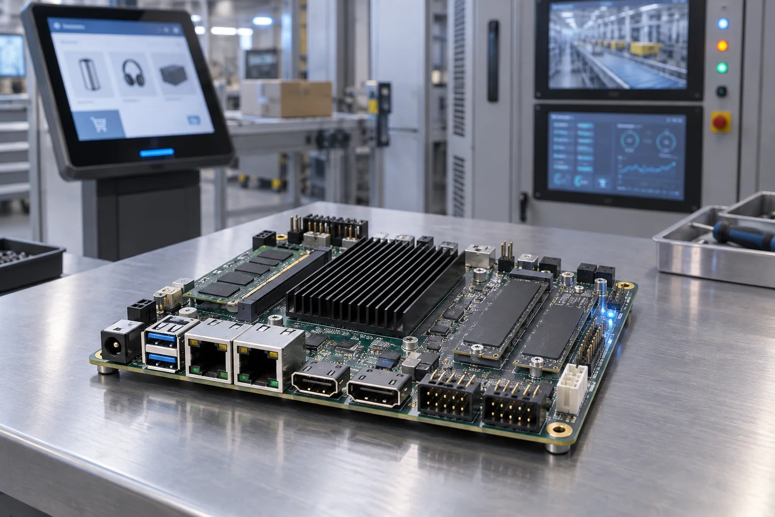

A computer motherboard sits on a workbench in a modern electronics manufacturing facility.

A computer motherboard sits on a workbench in a modern electronics manufacturing facility. Under the Hood: Intel Wildcat Lake and Memory Architecture​
