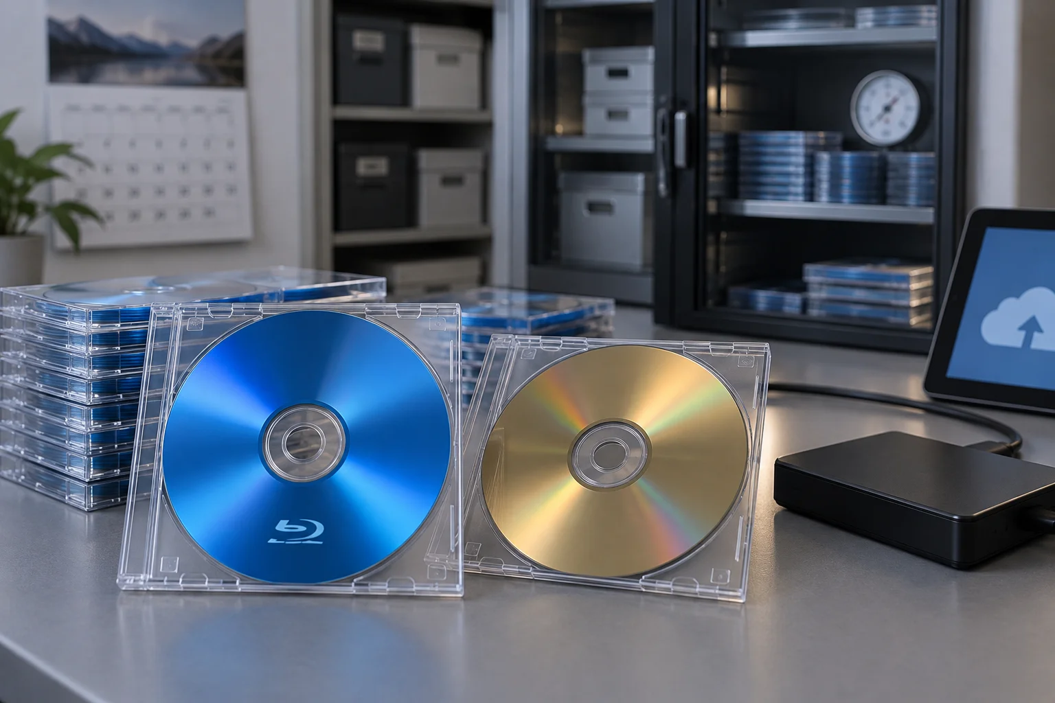

Blu-ray and DVD discs sit in cases on a desk beside stacked media and a tablet displaying a cloud upload icon.
Pop quiz: how long will the Blu-ray you burned this weekend stay readable? Anyone who answers with a single number is selling something. The Canadian Conservation Institute (CCI) says the lifespan of a recordable disc depends heavily on how it's built, recorded, stored and handled. The better questions are which kind of disc you have and what you do with it afterward.
Blu-ray and DVD discs sit in cases on a desk beside stacked media and a tablet displaying a cloud upload icon. The short answer: it depends on the disc​
