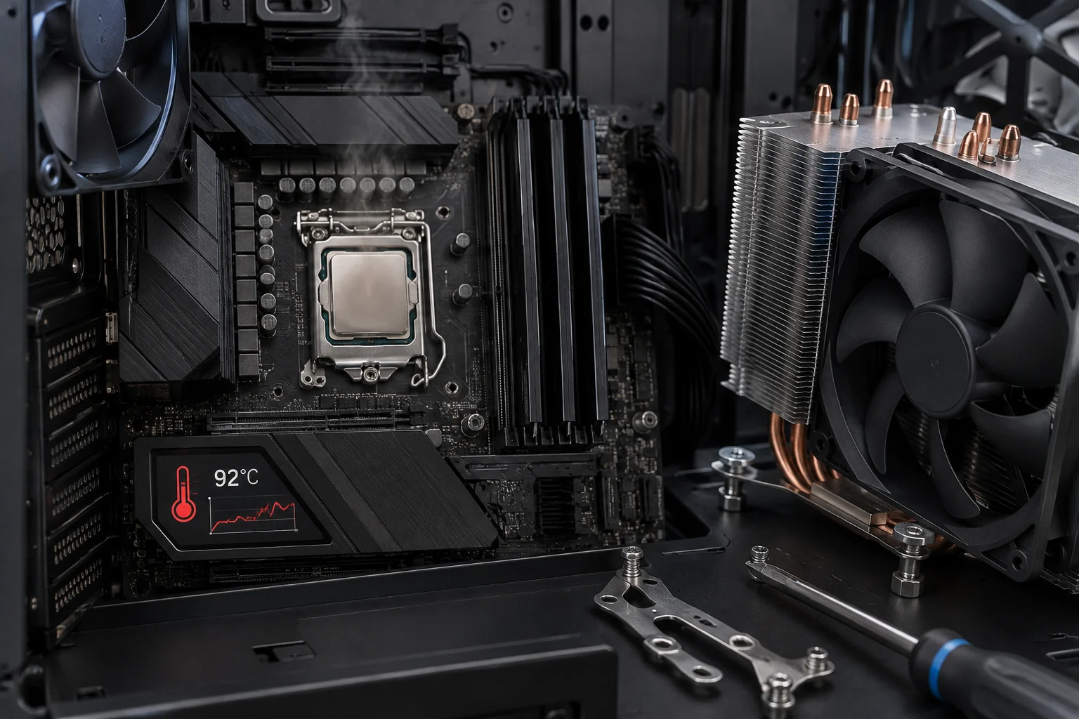

An open desktop PC shows a motherboard, exposed processor, and large cooling fan beside a 92°C temperature warning.
Powering up a PC with no CPU cooler is one of those mistakes that sounds like a horror story and usually isn't a catastrophe the first time. It's still a bad idea. Modern processors have safeguards, but those safeguards are emergency brakes, not a licence to skip the cooler. BGR's recent explainer covers the basics. The manufacturer documentation lets us tighten up a few of its claims.
An open desktop PC shows a motherboard, exposed processor, and large cooling fan beside a 92°C temperature warning. The short answer​
With no cooler, the CPU heats up almost immediately. A modern chip should throttle, cutting power and clock speed. If that isn't enough, the system should shut itself down.
Intel's documentation describes this two-stage protection. AMD is blunter: proper cooling is mandatory to avoid damaging the processor, and damage can occur very quickly if it is powered up without a heatsink present.
So the safeguards are real, and the warning is also real. If you boot coolerless once by accident and the machine shuts off, you probably haven't ruined anything. Nobody guarantees that, though, and you shouldn't treat it as a test you can repeat.
