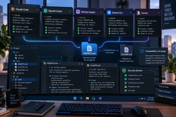

A desktop monitor displays five AI coding assistants sharing AGENTS.md project guidance and security checks.

Anthropic says version 2.1.277 reads AGENTS.md “instead” in a project with no CLAUDE.md; the behavior can be changed in the Project instructions area of Claude Code’s /config command. The feature is also unavailable for Claude Code deployments through Amazon Bedrock, Google Vertex AI, and Microsoft Foundry at launch.
The distinction between “fallback” and “merge” is the part that changes operational planning. A development team may have assumed that adding an AGENTS.md file to a repository would immediately give every supported coding agent the same policy, build commands, test requirements, and secure-development rules. It will for tools that already prioritize that file, but a Claude Code session running with the default setting will continue to follow CLAUDE.md wherever that file exists.
Anthropic’s published source for the built-in feature shows several possible modes: Claude-only instructions, CLAUDE.md-or-AGENTS.md, a mode that reads both, and a managed-only option. The default fallback mode also detects a project-level CLAUDE.md before standing down from AGENTS.md. In practical terms, a stale CLAUDE.md can remain the effective policy even after a team has started treating AGENTS.md as its shared source of truth.
That is a sensible backward-compatibility choice. It is also a predictable source of policy drift if the migration is treated as a rename rather than a configuration change.
