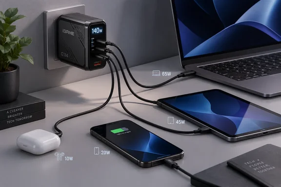

A 140W wall charger powers a laptop, tablet, phone, and earbuds on a desk.

The G114 has three USB-C ports and one USB-A port. COLORFUL rates C1 and C2 individually for up to 140W using USB Power Delivery 3.1 Extended Power Range (EPR) at 28V/5A. C3 and USB-A are each rated for up to 30W. The charger’s total output ceiling is 140W: C1 and C2 cannot each deliver 140W at the same time.
COLORFUL advertises shared-power examples of 100W + 30W, 65W + 45W + 18W, and 100W + 7.5W + 7.5W. Those figures are more useful to a multi-device desk than the single-port maximum. They also leave a question unanswered: the announcement does not map each example to a precise port combination or explain exactly what happens to an active connection when another device is plugged in.
For a Windows laptop, check its USB-C charging requirements before treating this as a replacement for its supplied adapter. Reaching the advertised 140W requires a compatible device and an appropriately rated USB-C cable; USB-IF’s cable-rating guidance distinguishes cables intended for higher-power USB PD operation. A laptop that needs more power during demanding work may charge more slowly, or still need its original power supply. That is a compatibility consideration, not a measured result for the G114.

The built-in iGame Display is specified to show total output, output by port, cumulative usage time, and temperature status. That could make it easier to spot when a laptop receives less power after other devices are connected—without opening an app or attaching a separate USB meter. COLORFUL has not provided independent figures for the display’s accuracy or detailed information about its temperature reporting.
