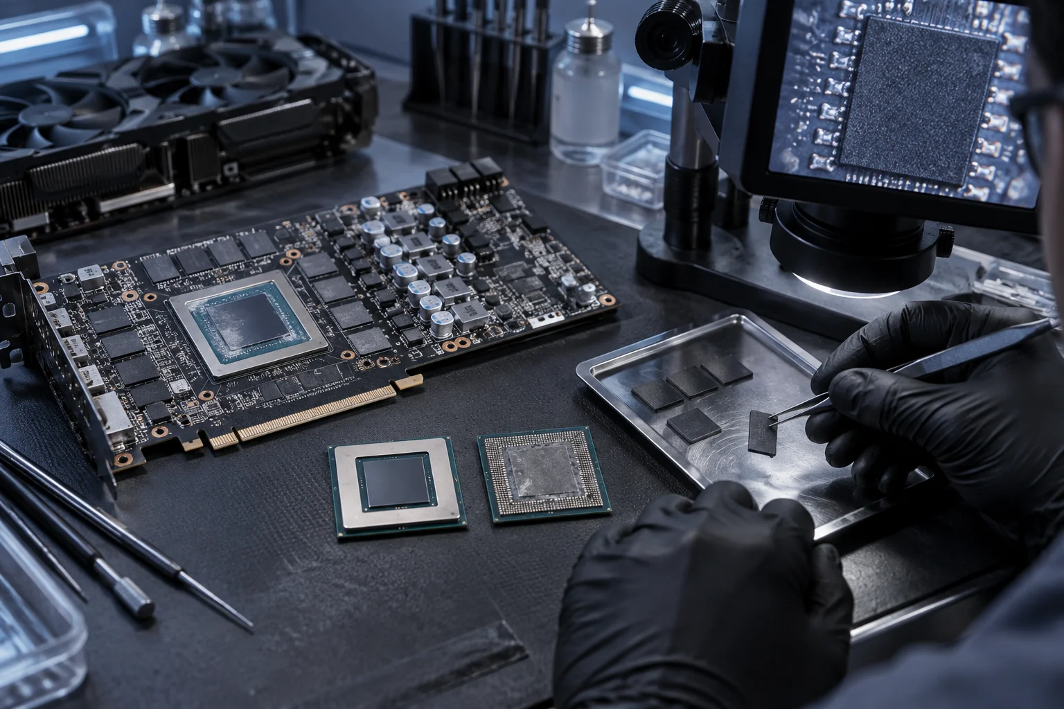

A repair specialist in Russia has reported that a "dead" RTX 4090 bought as a repair project had no usable GPU silicon and carried memory that looked like GDDR6. That is the wrong type for this card. TweakTown covered the case on October 10, 2026, drawing on VideoCardz, which spoke directly with the specialist, who goes by Vik-On. The details are worth knowing for anyone who buys, repairs or resells graphics hardware. Buyers of "for repair" cards and anyone sourcing second-hand GPUs for a Windows workstation or gaming rig are the most exposed.
A technician uses tweezers to inspect graphics card components under a microscope. What was reported​
Vik-On's client paid about 30,000 rubles, roughly $350, for a dead RTX 4090 that he hoped to revive. According to VideoCardz, the seller offered it as a bare PCB with no cooling system, which made it hard for the buyer to check whether it worked. That detail matters. With no cooler fitted, a buyer can't sensibly power the board and test it.
The teardown found a counterfeit GPU package that imitated the real chip closely. VideoCardz says the makers copied the RTX 4090 label, the package, the chip markings and the compound around the processor. The part was also soldered down with a ball grid array, so it looked factory-installed rather than glued on.

  • Vik-On noticed differences in the substrate color, the surface reflections and the lettering.
  • After the package was removed, the contact area did not look like that of a functional processor, and the solder mask began deteriorating during cleaning.
  • There was no usable RTX 4090 silicon inside, so the board cannot be restored to a working RTX 4090.
The memory problem​
The memory was counterfeit too. Its markings were close enough to genuine Micron parts that even the repair specialists struggled to tell them apart at first. After one package was removed, it appeared to be GDDR6, not GDDR6X. The wording is hedged in the reporting, so it is a strong indication rather than a lab-certified identification.
