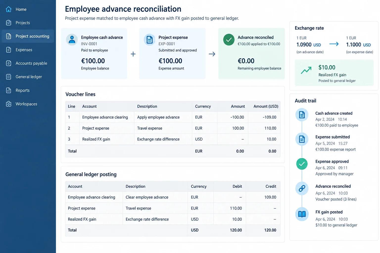

An accounting dashboard shows a €100 employee advance reconciled with expenses, including a $10 FX gain and ledger entries.

An accounting dashboard shows a €100 employee advance reconciled with expenses, including a $10 FX gain and ledger entries. Why Legacy Cash Advance Settlements Leave Phantom Balances​

Microsoft Learn provides a concrete walkthrough that illustrates the exact ledger math:
Transaction StageTransaction Currency (EUR)Accounting Currency Equivalent (USD)Ledger & Settlement Impact
1. Cash Advance Issued100 EUR140 USDEmployee receives 100 EUR advance.
2. Expense Submitted100 EUR150 USDExchange rate shifts; 100 EUR now equals 150 USD.
3. Automated Settlement0 EUR Remaining10 USD VarianceEUR advance clears to zero; 10 USD posts to configured FX Gain account; employee vendor balance nets to zero.
In this scenario, the employee was advanced 100 EUR and spent 100 EUR. In the real world, the employee owes nothing and is owed nothing. Under the new logic, the system maps the expense to the cash advance in the transaction currency (EUR), clearing the EUR advance balance completely. Because the accounting currency value rose from 140 USD at issuance to 150 USD at settlement, the 10 USD difference is automatically recognized as a realized FX gain and posted to the organization's configured FX Gain account, ensuring the employee vendor balance nets cleanly to zero.
