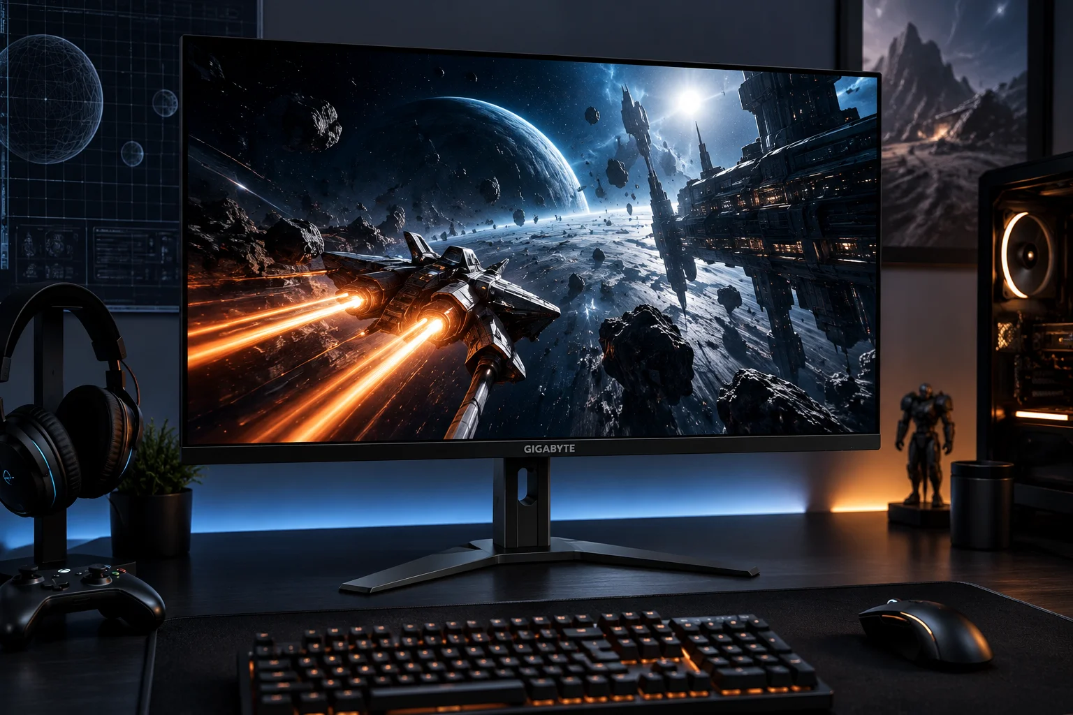

A gaming desk setup features a Gigabyte monitor showing a spaceship racing through an asteroid field.

A gaming desk setup features a Gigabyte monitor showing a spaceship racing through an asteroid field. The short version​
