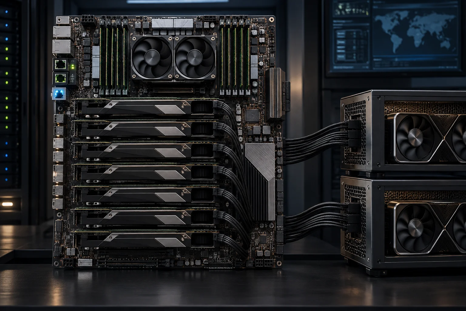

PCIe slots and the nine-GPU claim
Seven full-length PCIe 5.0 slots connect directly to the processor. Six run at x16 and the seventh at x8. Two MCIO 8i connectors add more PCIe devices and storage expansion.
Here is where "nine GPUs" comes from. At Computex, Gigabyte demonstrated a configuration supporting up to nine GPUs by connecting two additional graphics cards externally. So:
- It is seven in-board slots plus two externally attached cards via MCIO.
- It does not mean nine slots, and nine cards won't fit in a normal tower.
- The reporting doesn't detail the cabling, enclosure, or which GPU models work.
Anyone planning a build should also think about card thickness and slot spacing, power delivery, and cooling for the cards themselves. The board can't solve those problems.

The WRX90 AI TOP looks like a capable platform for local AI work, with eight-channel ECC memory, plenty of PCIe 5.0, remote management and Windows 11 support. The three big claims need reading carefully:
- 2 TB is a maximum.
- The 43 °C cooling figure comes from Gigabyte and has no stated test method.
- Nine GPUs was a demonstration with external connections, not nine slots.
Until pricing, benchmarks and independent thermal tests arrive, it is a promising spec sheet rather than a proven buy.
