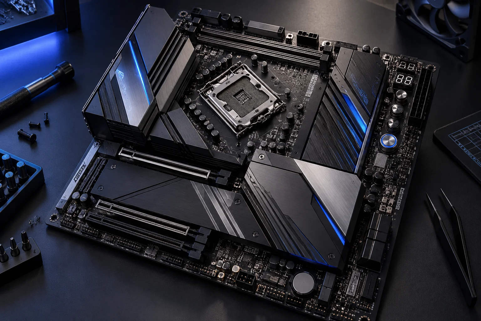

Gigabyte’s X870 Aorus Infinity puts its intended audience on display before a processor is even installed. The rotated AM5 socket, memory slots above the CPU and exposed tuning controls suggest a motherboard built for people who regard a failed boot as useful feedback rather than a ruined evening. HardwareZone Singapore’s first look examines that enthusiast-focused design—but offers no benchmarks, so the unusual layout should not be mistaken for proven performance superiority.

A black gaming motherboard with blue accent lighting lies on a workbench beside computer repair tools. An unconventional layout with a specific purpose​
HardwareZone reports that Gigabyte rotated the CPU socket by 90 degrees and placed the two DDR5 slots above it to shorten and improve the consistency of processor-to-memory signal paths. That moves the primary M.2 position to the socket’s right. This is Gigabyte’s engineering rationale, not a measured advantage established by the preview.
The surrounding construction is equally deliberate. Gigabyte lists a 10-layer PCB, 110A power stages and an 18+2+2 power design, qualifying the first section as a 9+9 parallel arrangement. Large VRM heatsinks use a direct-touch heatpipe, while a rear thermal plate covers the board’s back. Those specifications describe the hardware; they do not independently establish operating temperatures or overclocking headroom.
HardwareZone also highlights a sliding cover over the twin eight-pin CPU power connections, screwless M.2 fittings and the EZ-Latch Up graphics-card release. These are less dramatic than record-chasing memory speeds, but their purpose is easy to appreciate: make repeated component changes less fiddly.
Physical fit deserves attention, too. At 305 × 275mm, the Infinity is E-ATX. Before ordering, compare those dimensions with the case’s motherboard clearance and cable-routing layout—not simply its advertised form-factor support.
The controls are the real enthusiast feature​
HardwareZone describes an accessible row of power, reset, clear-CMOS, cold-reset and external-clock controls, alongside voltage-measurement points and two diagnostic displays. Its accessory inspection also identifies a CPU Thermal Matrix attachment and a socket backplate intended for liquid-nitrogen cooling hardware.
The practical appeal is workflow rather than decoration. For someone repeatedly adjusting settings, checking startup behavior and recovering from unsuccessful attempts, accessible controls can matter more than another illuminated heatsink. That is the strongest interpretation of this design—not a promise that every processor installed in it will suddenly discover hidden talent.
