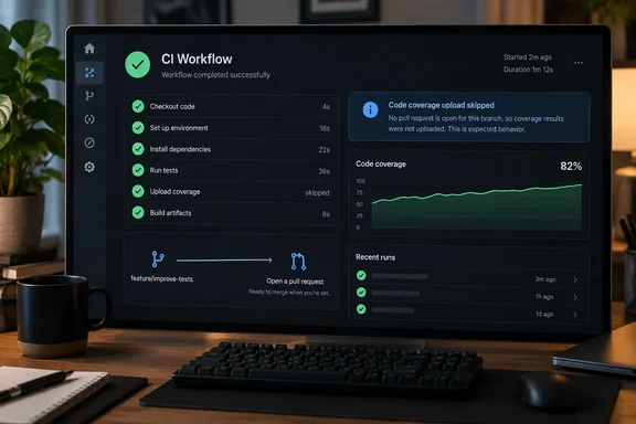

A desktop monitor displays a successful CI workflow dashboard with completed build steps and an 82% code coverage chart.

  • The first push to a branch with no open pull request now skips the coverage upload instead of failing.
  • Later pushes to that branch also skip the upload, until a pull request is opened.
  • The reason for the skip appears in an Actions notice and in the step summary.
  • Pushes to the default branch and supported pull request events work exactly as before. You don't need to change any existing workflow configuration.
Summary: Pushes to a branch with no PR now get a clear "skipped" message instead of a failed check. Nothing else about the upload has changed.
