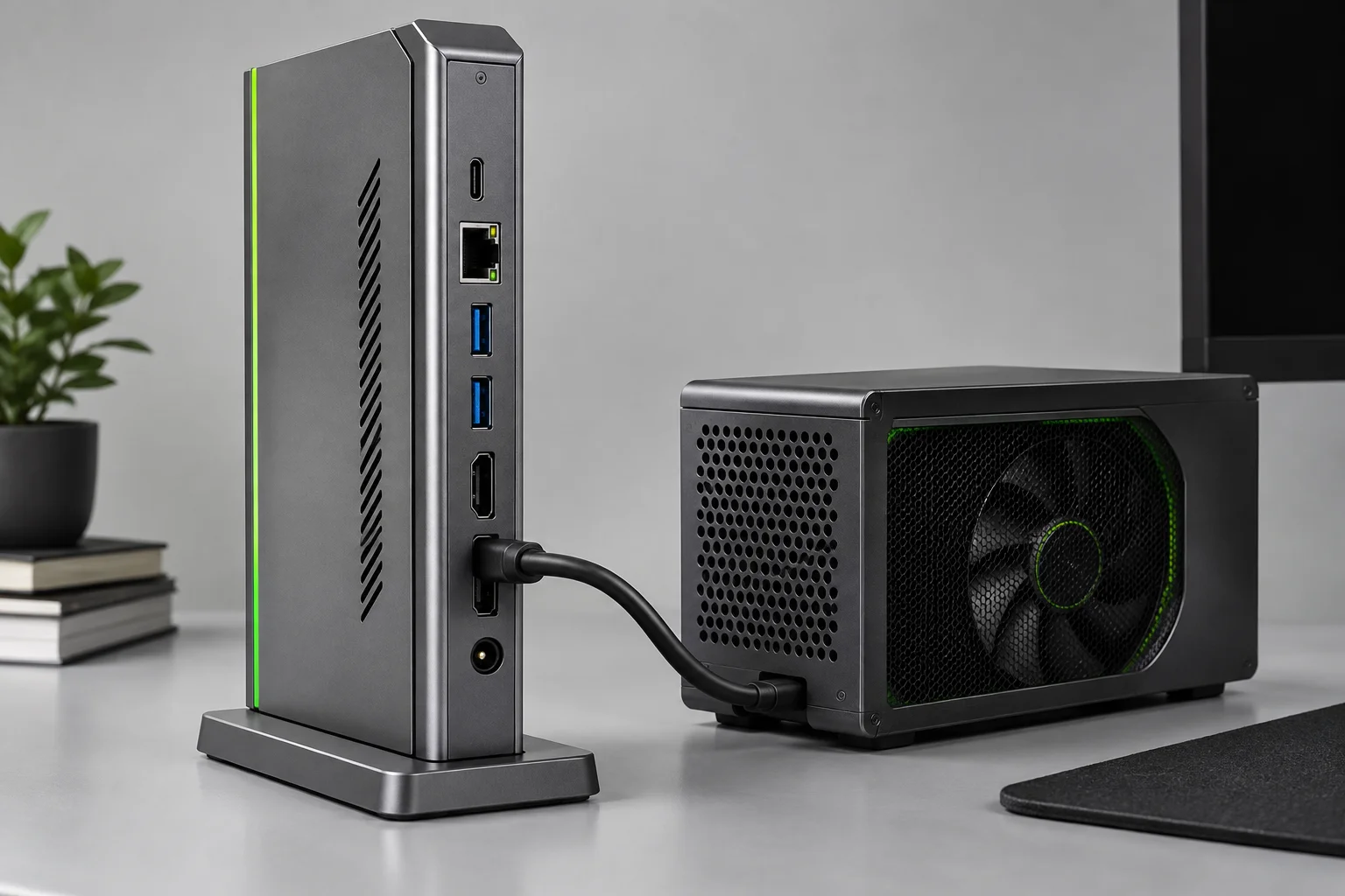

A different chassis from the EVO-X2
According to the review, the EVO-X2 had a plastic chassis, while the X3 is fully metal. It is also more committed to standing upright. The supplied base is required, and the review notes that the base carries the printed system and regulatory information. Other coverage describes the enclosure as a vertical CNC metal slab about 14 inches tall.
The review points out a few practical quirks:
- Ventilation runs along both sides and the top, with visible heatsinks at the rear, so those surfaces need to stay clear.
- The top is the one significant non-metal area, used to route the wireless antennas.
- The base is held on by two screws. The rubber feet cover those screws, so the feet have to be removed to reach them.
- Because the feet are adhesive, the reviewer says the design isn't meant to be opened many times.
GMKtec's own marketing pitches the machine as a thermally capable design. A third-party retail summary lists power modes up to 140W peak and a triple-fan cooling design. The review excerpt has no thermal measurements, so those figures are vendor claims for now.

OCuLink: what it gives you and what it doesn't
GMKtec routes four of the SoC's PCIe lanes to the OCuLink port. The review says the port can technically connect any device, but the common use is an external GPU dock. The OCuLink spec tops out at PCIe Gen4 x4, or roughly 64Gbps. That is more bandwidth than USB4 or Thunderbolt 4, but less than a full x16 slot. The review says it exceeds even Thunderbolt 4 systems in available bandwidth. The Ryzen AI Max chips only provide 16 Gen4 lanes, so there are few spare to hand out.
The limitation to remember is that OCuLink does not hot-plug. The review reports a warning sticker on the machine. GMKtec's product page says the eGPU dock is sold separately and that hot swapping may damage the motherboard. A retail listing gives the same instruction: power off the device before connecting or disconnecting OCuLink devices.
The reviewer does credit the layout. The OCuLink port sits to the left of the DC power jack, which keeps it away from the hot-pluggable USB ports and lowers the chance of plugging the wrong cable into it.
If you want an eGPU that you attach and detach casually, this isn't that. It suits a dock that stays connected, with a shutdown before every change.
