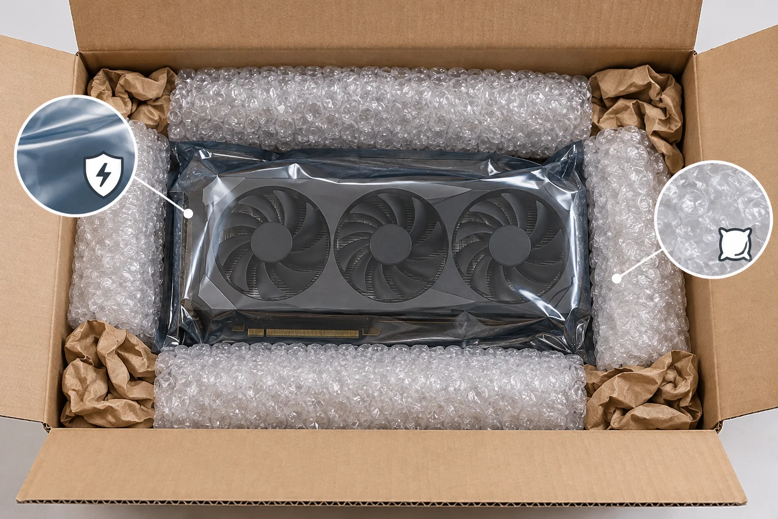

A triple-fan graphics card is secured in an antistatic bag inside a box cushioned with bubble wrap and packing paper.
Is bubble wrap really a GPU killer? BGR's Jorge Luis says it is. He argues that ordinary bubble wrap can build up static and discharge into a graphics card in transit. The reality is more nuanced, and the nuance affects how you should pack a card.
A triple-fan graphics card is secured in an antistatic bag inside a box cushioned with bubble wrap and packing paper. The claim, and where it overreaches​

This is the key distinction. Cushioning and ESD protection are two separate jobs. Ordinary bubble wrap does the first. Whether a given roll does the second depends on how it is made and rated. Anti-static bubble wrap exists, and BGR mentions it as an option for shipping electronics. You can't tell which kind you have just by looking at it. Marketing claims and colour alone are weak evidence.

  1. Use the original box if you still have it. BGR notes that retail boxes are designed to protect the card and often include an ESD bag. Don't assume every box does. Check yours.
  2. Put the bare card in an ESD bag. Use a proper static-shielding or antistatic bag, not a grocery bag or a clear poly bag.
  3. Add cushioning around the bagged card. This is where bubble wrap earns its place. It sits in the physical-protection layer, outside the ESD bag.
  4. Use a sturdy outer carton and fill the voids. The card shouldn't be able to slide, rattle or get crushed. Heavy cards with large coolers are more vulnerable to bending and impact than to static.
