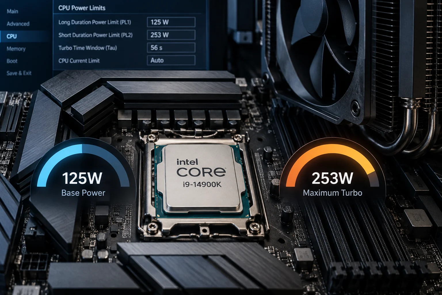

An Intel Core i9-14900K sits on a motherboard beside graphics showing its 125W base and 253W turbo power limits.
The Core i9-14900K is sold as a "125W" chip, but Intel's own spec sheet gives it a much higher turbo ceiling. Intel lists its Processor Base Power at 125 W and its Maximum Turbo Power at 253 W. That is just over twice the headline figure. The gap matters if you're sizing a cooler, a motherboard or a power supply. It's also easy to misread, so here is what the numbers do and don't mean.
An Intel Core i9-14900K sits on a motherboard beside graphics showing its 125W base and 253W turbo power limits. What the two numbers mean​
Intel changed its terminology a few generations ago. Its support documentation says TDP has been replaced by Processor Base Power starting with 12th-generation Core processors. The "125W" on the box is therefore the base-power figure. Intel's TDP support page describes it as the steady-state design target. The same page says power can exceed that level during turbo operation or certain workloads, such as AVX. That excess lasts only for a limited time, or until the chip hits a thermal throttle temperature or a power-delivery limit.
The 253W figure is a different kind of number. TechPowerUp's testing recap describes Maximum Turbo Power as the maximum sustained (>1s) power dissipation of the processor as limited by current and/or temperature controls. It is a ceiling, not a constant draw. Your 14900K won't pull 253W while you browse or run Excel. Actual consumption depends on the workload, the cooling and the platform.

Intel's engineering documentation describes two power levels. PL1 is the long-term average-power limit. PL2 is a higher level that can be held for a limited time. Tau is the time constant that governs how long PL2 can last. Intel's datasheet says a larger Tau means a longer PL2 duration. It also says Tau should be set to match what the cooling solution can handle.
Two corrections to common shorthand:
  • Tau is not a temperature and it is not a hard stopwatch. It is an averaging constant in Intel's power-control scheme, so boost duration isn't a fixed number of seconds on every system. Thermal throttling is a separate protection mechanism.
  • Board firmware can change the behaviour. TechPowerUp notes that Maximum Turbo Power may be configured by the system vendor and can be system specific. The same review notes that the 14900K is designed to operate at 253 W, with PL1=PL2, so on boards using those settings there is no power throttling after a minute or so.
So the 253W figure is not a short burst on every board. Two 14900K systems can behave quite differently depending on firmware defaults.

  3. Check your motherboard's BIOS power-limit settings. Look at the PL1, PL2 and Tau values, or the board's profile names. The vendor's documentation and reviews of that specific board show what it does by default.
