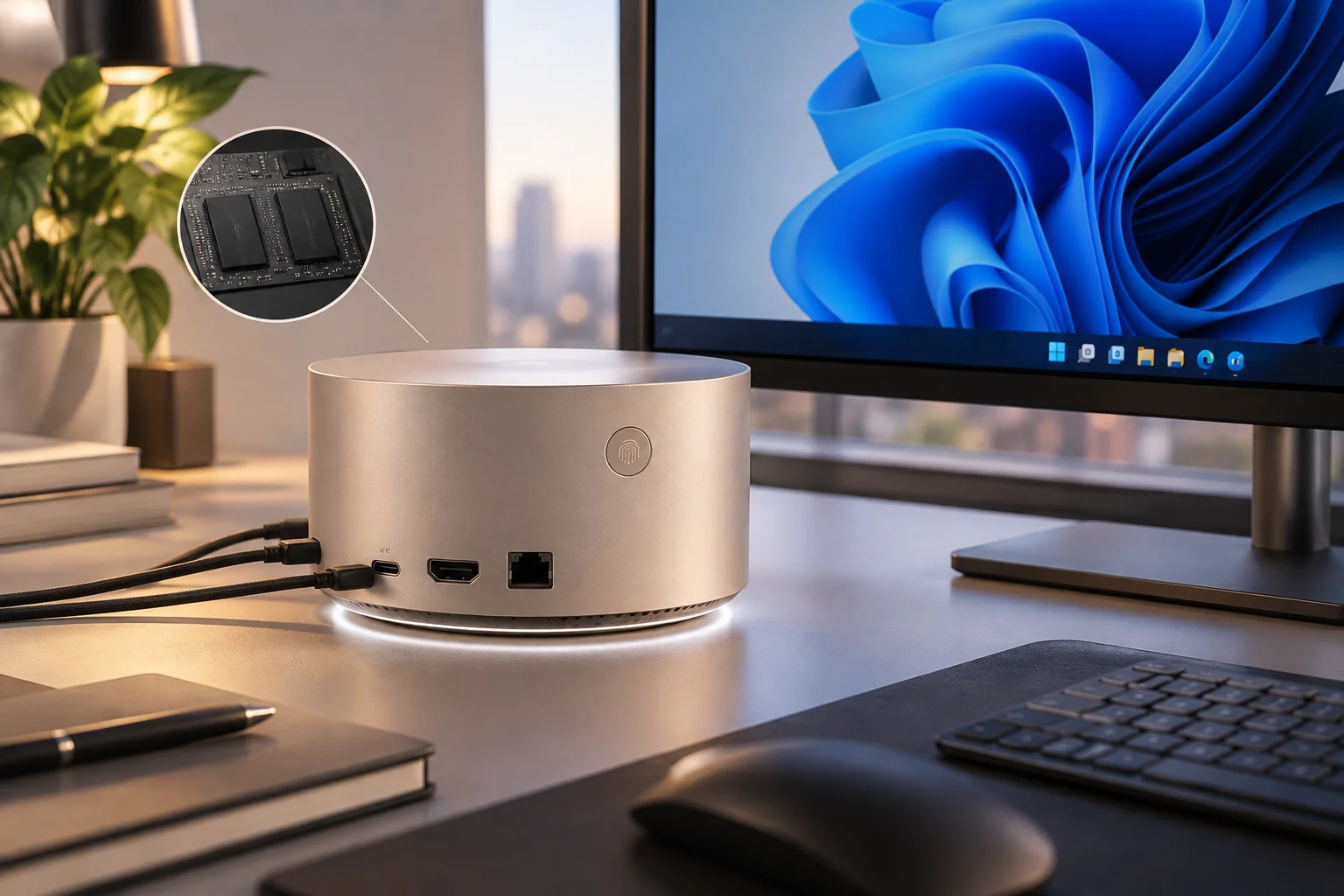

A silver desktop computer hub with a fingerprint sensor and ports sits beside a monitor displaying Windows 11.
Lenovo's Yoga Mini is a puck-shaped Windows 11 desktop. XDA-Developers rates it 8/10, and its main selling points are that it is a mini PC that does not look like a box. Look past the styling, though, and the review comes down to ports, cooling, price and one hard limit on upgrades.
A silver desktop computer hub with a fingerprint sensor and ports sits beside a monitor displaying Windows 11. What Lenovo built​
Lenovo's own CES 2026 announcement called the system the Yoga Mini i. It uses a cylindrical aluminum chassis of 0.65 liters and weighs about 600 grams. StorageReview, which tested a unit independently, gives the dimensions as 130 x 130 x 48.6mm. Its spec table lists the finish as Seashell and the power supply as a 100W USB-C adapter.
The XDA reviewer wanted a mini PC that was meant to be seen on the desk. Three details back that up:
  • Fingerprint reader: it is built into the power button and works with Windows Hello.
  • Accelerometer: it turns the top of the chassis into a customizable tap button. XDA compares it to tapping the back of an iPhone.
  • Light ring: StorageReview says an Adaptive Lighting ring on the underside reacts to touch and notifications.
Lenovo also advertises presence detection that works through Wi-Fi. Lenovo's description is that it is marketed as a Copilot+ PC, which matches the "AI PC" label in XDA's headline. That label is a marketing term. In practice this is a compact Windows desktop with an NPU rated up to 50 TOPS on the X7 model. Whether that NPU matters depends on which AI features you actually use.

Upgrades and servicing​
Memory is the hard limit. Lenovo's specifications describe the memory as soldered with no slots, which StorageReview records as "not upgradable". Choose 16GB or 32GB at purchase, because that is what the machine keeps. XDA's checklist also warns off anyone who needs more than 32GB.
Storage can be replaced, with some effort:
  1. Lenovo's service manual documents removal of the top and base covers.
  2. Neither cover is screwed down. Both XDA and StorageReview say the official procedure calls for a suction cup.
  3. Once the base cover is off, StorageReview reports the SSD sits under a heatsink and is held by a single Phillips screw. It says Lenovo lists support for drives up to 2TB.
  4. Tom's Guide reports there is only one SSD slot, so a larger drive means cloning the original.
StorageReview opened its unit "in a few minutes".

My read, as general analysis rather than anything measured: the Yoga Mini is a good Windows mini PC with a distinctive design. It also needs a fair amount of clearance, since StorageReview notes that the fan exhausts through the same ring as the intake and the unit needs space on all sides. If you like the look and can live with fixed RAM, it makes sense. If you only care about performance per dollar, a conventional box will probably go further.
