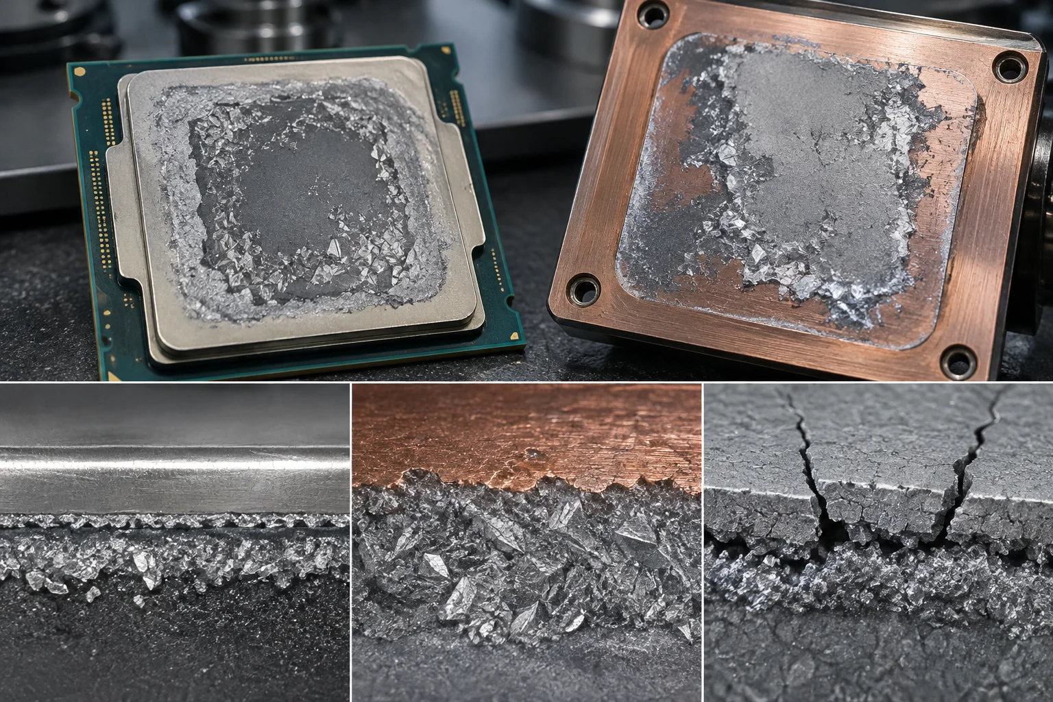

Close-up collage of computer processors and copper cooling plates coated with cracked, crystalline residue.

Close-up collage of computer processors and copper cooling plates coated with cracked, crystalline residue. The Two-Year Electron Microscope Experiment​
To figure out what actually happens over time, Hartung tracked a liquid metal application across a 24-month window using an electron microscope. Because liquid metal alloys—such as Thermal Grizzly's Conductonaut—rely on a blend of gallium, indium, and often tin, they remain liquid well below room temperature. While pure gallium melts at roughly 29.8°C (about 85.6°F), alloying it with indium and tin in a eutectic mixture drops the melting point to around 11°C. Moreover, peer-reviewed materials research published in Advanced Functional Materials notes that gallium-based liquid metals have effectively zero vapor pressure at room temperature, meaning they simply cannot evaporate the way solvent-based silicone thermal pastes do.
In Hartung's long-term observation, the timeline of physical change was remarkably front-loaded:
  • At the 1-hour mark: The TIM remained visibly liquid under examination.
  • At the 2-month mark: All visible liquid had disappeared, replaced by a field of solid crystals across the contact surface.
  • At the 2-year mark: The crystalline structure looked identical to the two-month inspection. As Hartung noted, after two full years, the material honestly did not change any further.

Every tube of liquid metal comes with a bold warning never to use it on aluminum heatsinks, and Hartung's demonstration illustrated exactly why. Once the thin natural oxide skin on aluminum is scratched or breached, liquid gallium aggressively migrates along the aluminum's internal grain boundaries.
In a demonstration using a scrap 2 mm aluminum sheet, visible surface swelling appeared after just five minutes, and the metal became completely brittle within half an hour. This phenomenon—known in materials science as liquid metal embrittlement and documented in Physical Review Letters—causes polycrystalline aluminum to suffer intergranular fracture under minuscule mechanical stress. Put simply: put gallium on an aluminum cooler, and the baseplate will literally crumble.

Copper is the gold standard for PC water blocks and heatpipes, boasting a stellar thermal conductivity of roughly 400 W/m·K. However, bare copper and gallium are chemically eager partners. In Hartung's testing on the bare copper cold plate of a Thermal Grizzly stainless steel water block, liquid metal could no longer be wiped away with acetone or isopropyl alcohol after less than five minutes of contact.
Instead of sitting passively on the surface, one copper atom bonds with two gallium atoms to form an intermetallic compound called $\text{CuGa}_2$. As the gallium gets locked into this solid crystal lattice, the leftover indium and tin from the TIM alloy segregate into their own solid pockets, making the entire application look like it has dried up.
What does that mean for your thermals and maintenance?
  • Thermal Conductivity Drop: The $\text{CuGa}_2$ reaction layer has a thermal conductivity of about 100 W/m·K—roughly one-quarter of bare copper's 400 W/m·K rating. Because the layer is microscopic, it does not ruin the entire cooler's performance, but it does alter the immediate contact interface.
  • Growth Rate: Depending on operating temperatures and how much liquid gallium is pooled on the surface, the $\text{CuGa}_2$ layer grows at roughly 1 micrometer per day until it plateaus between 50 and 100 micrometers thick. In a controlled test pressing pure gallium between copper plates at 70°C, the reaction layer reached about 4 micrometers over 96 hours.
  • Permanent Solidification: Once $\text{CuGa}_2$ forms, it remains solid all the way up to approximately 254°C. Your CPU or GPU will hit thermal shutdown long before approaching a third of that temperature, meaning the compound will never melt back into a liquid inside a PC.

When gallium meets a nickel-plated cold plate, it still reacts, forming a solid intermetallic compound that Hartung identifies as $\text{NiGa}_5$ (one nickel atom to five gallium atoms). While independent high-temperature metallurgical studies published in Materials note that gallium-nickel interfaces can form varying phases such as $\text{Ga}_7\text{Ni}_3$ alongside gallium-rich $\text{Ga}_5\text{Ni}$ layers depending on temperature, the practical takeaway for PC cooling is how thin the barrier stays.
According to Hartung, nickel plating restricts the solid reaction layer to roughly one-tenth the thickness seen on bare copper—measuring just 1 to 5 micrometers in his commentary, or 5 to 10 micrometers on his accompanying presentation slide. Even though $\text{NiGa}_5$ conducts heat less efficiently than $\text{CuGa}_2$, the layer is so vanishingly thin that its thermal penalty is negligible. Better yet, because the nickel plating stops the copper underneath from drinking up the gallium, your liquid metal pool stays intact rather than turning into a dry-looking crust requiring a re-application.
