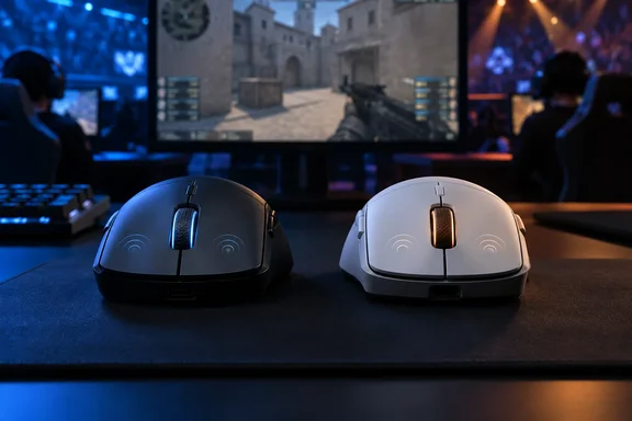

Two gaming mice, one blue-lit and one orange-lit, sit before a monitor in a dim gaming setup.
