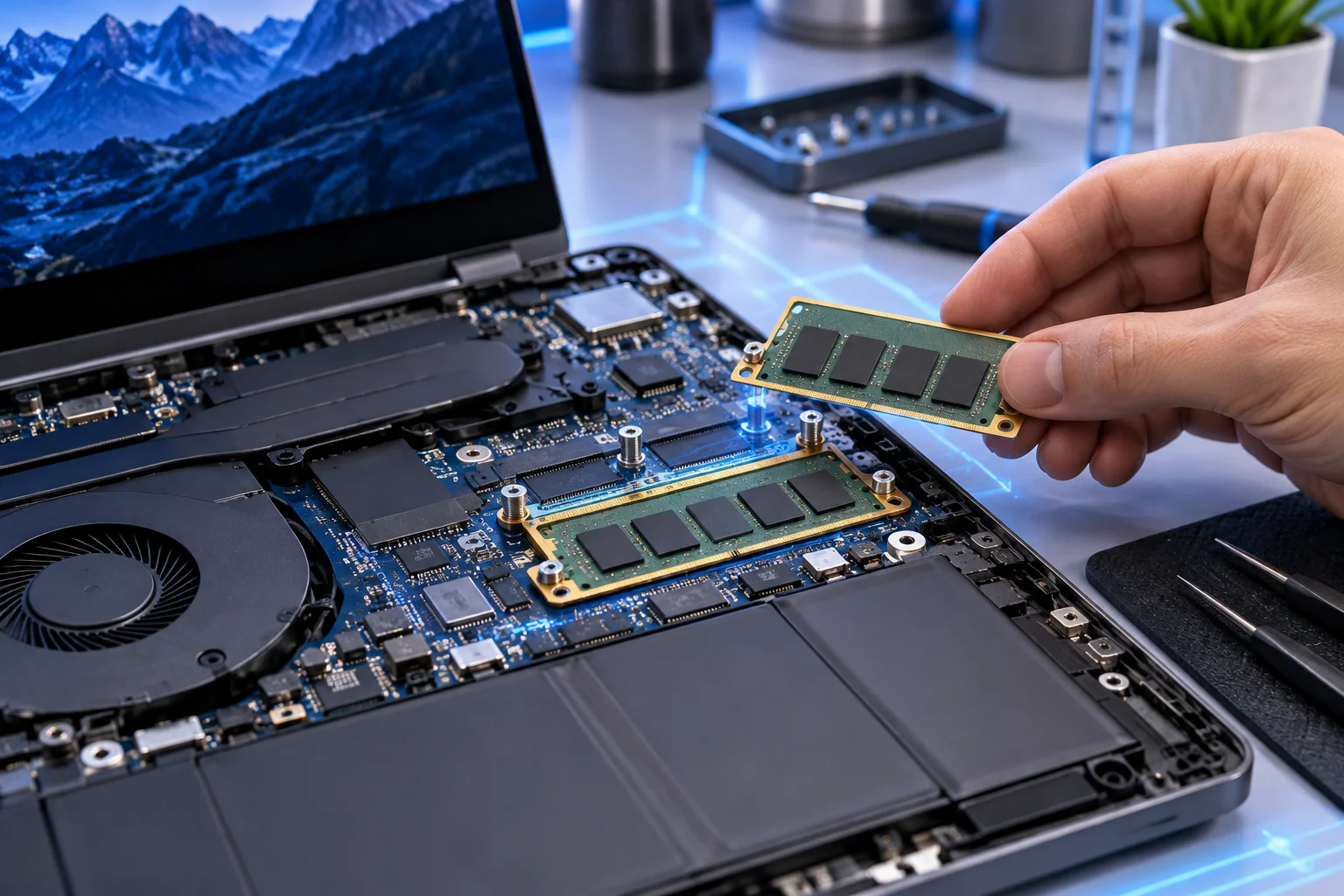

A hand holds a RAM module over an opened laptop during a hardware upgrade or repair.

A hand holds a RAM module over an opened laptop during a hardware upgrade or repair. What LPCAMM2 is, and what it isn't​
LPCAMM2 is a module format, not a new type of memory. It is a flat module that presses onto a contact grid on the motherboard and is held down with screws. Instead of an angled stick clicking into a socket, the module sits flat. The short, clean electrical path is what lets LPDDR5X run at speeds that SO-DIMMs struggle to reach.
The DRAM chips are still LPDDR, and they sit on the removable module rather than on the laptop's board. That distinction matters for pricing, as covered below.
