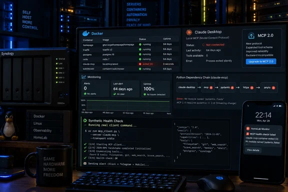

Server dashboard shows Docker containers, a failed Claude MCP service, dependency errors, and mobile health alerts.
A Synology MCP server in one homelab was effectively offline for 64 days without triggering an alert, because the failure happened before the service could expose a port, remain running, or register as unhealthy. The incident, detailed in a first-person report by XDA Developers, is a useful warning for anyone using Claude Desktop, uv, Docker, and self-hosted monitoring: a green container dashboard and a responding HTTP endpoint do not prove that a locally launched AI tool is usable.
The immediate culprit was an unbounded Python dependency. The server’s requirements allowed mcp>=1.28.0, so when the Model Context Protocol Python SDK published stable version 2.0.0 on July 28, 2026, the next uv environment resolution selected the major upgrade. The existing Synology integration still depended on a v1 API that version 2 removed, and the process exited before Claude Desktop could connect to it.
This was not an obscure break that package maintainers could not have anticipated. The MCP Python SDK’s own v2 release notes explicitly told projects that were not ready to migrate to retain an upper constraint such as mcp>=1.28,<2; the project also moved v1 into maintenance mode and changed APIs including the high-level server class and old import paths. The homelab failure therefore exposes a routine but consequential maintenance gap: the server’s dependency declaration described the minimum compatible version but made no promise about the maximum one.
