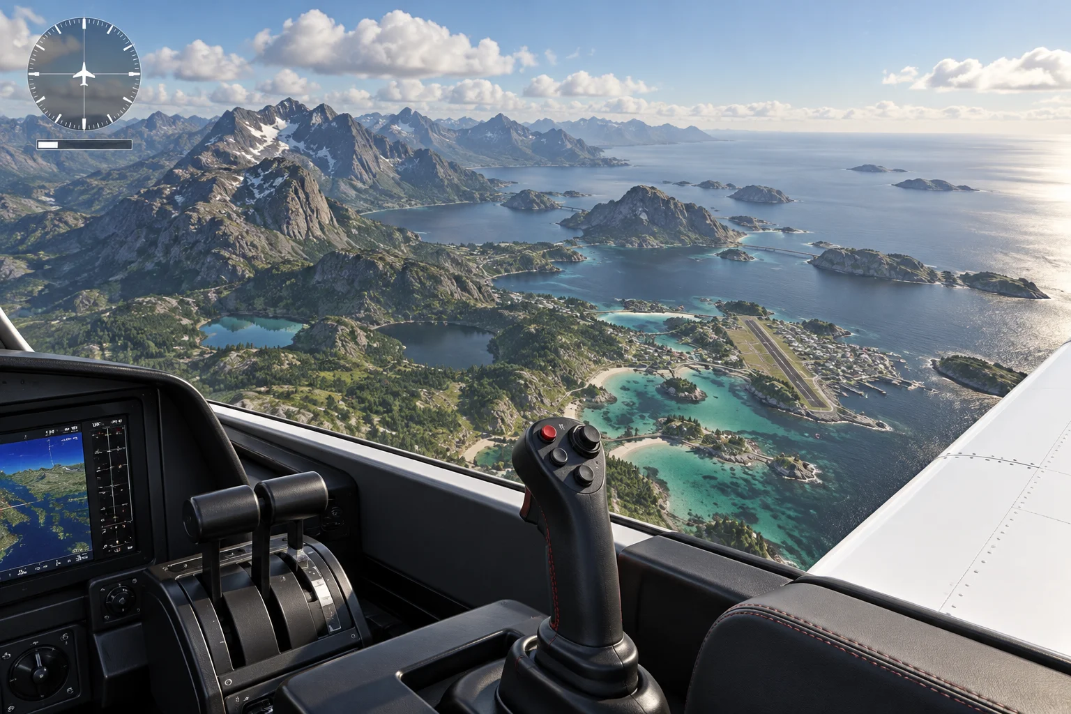

A cockpit view overlooks a rugged, snow-dusted island archipelago, turquoise bays, and a coastal runway.

A cockpit view overlooks a rugged, snow-dusted island archipelago, turquoise bays, and a coastal runway. What the beta changes​
