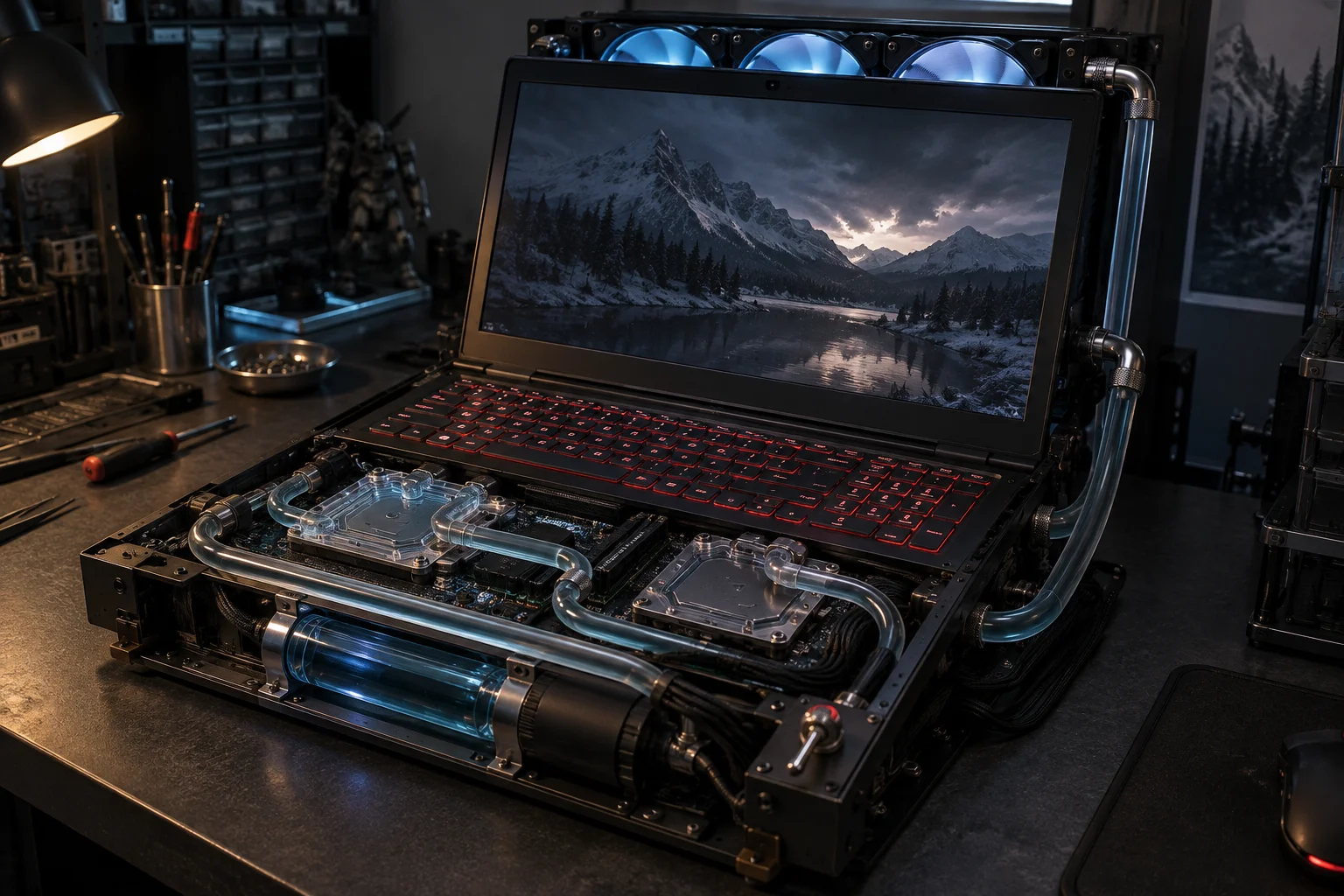

A YouTube modder has bolted a full 360mm liquid-cooling loop onto a laptop. Whether that counts as engineering or a cry for help depends on how you feel about epoxy. According to Tom's Hardware, TrashBench attached waterblocks, a pump and a 360mm radiator to a Metabox laptop with a GTX 1060 and a Core i7-8750H. The reported result is CPU and GPU temperatures about 60°C below stock, and under full load both stay below 40°C. This is one creator's testing, relayed by one outlet. It is not an independent benchmark, and nobody should treat it as a recipe.

According to Tom's Hardware, TrashBench started with a cut-up 360mm all-in-one cooler left over from another project. The build then grew in several steps:
  • Pump upgrade: He first wanted to reuse the AIO's pump with a second waterblock. Testing showed it wouldn't push coolant through two blocks, so he moved to a bigger standalone pump.
  • Extra waterblock: The standalone pump has no block attached, unlike an AIO's combined pump and block, so he needed another waterblock.
  • Block mounting: The blocks sit in a 3D-printed holder. It is screwed into the holes that originally held the stock heatpipe and blower cooler.
  • Radiator placement: The radiator sits behind the screen on 3D-printed mounts. The gap between display and shell was too small for screws, so he reluctantly used two-part Loctite epoxy.
  • RAM and VRMs: Thermal pads raise the RAM to the VRMs' height so one heatsink can cover each cluster. The VRM heatsink is held on with thermal paste and a dab of epoxy, which makes that part of the mod permanent.
  • Plumbing: Flexible clear tubing and screw-type hose clamps connect the blocks, pump and radiator.
After assembly he did a leak test. The article quotes him saying "I think we're good," just before some bubbles passed by. The reporting describes no long-duration leak test or reliability testing, so a brief check shouldn't be read as proof the loop is safe over time.

The laptop runs on 19V, while the pump and radiator fans need 12V. TrashBench soldered a DC-DC step-down converter to the original blower fan's electrical contacts to supply the cooling hardware.
The catch is that this supply comes on as soon as the laptop does. It has no way to ramp up only under load. He therefore added a toggle switch on a 3D-printed plate, screwed to the bottom shell. That shell has a large hole cut in it to make room for the pump and waterblocks. A 3D-printed riser screwed to the underside lets the laptop stand.

Tom's Hardware reports these results:
  • Temperatures: About 60°C lower than stock on both CPU and GPU during benchmarks and stress tests, with both staying well below 40°C under full load.
  • Performance: The initial gains were described as conservative. With the extra thermal headroom, TrashBench overclocked, and Forza Horizon 5 went from 75 FPS to 77 FPS, then to 83 FPS after overclocking.
  • Headline figure: The article cites an average 14% gain after overclocking.
