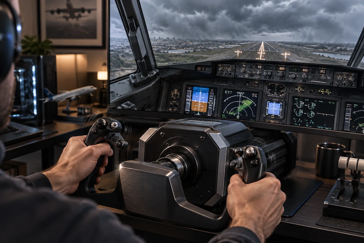

A person uses a flight simulator as a virtual cockpit approaches a runway beneath storm clouds.

A person uses a flight simulator as a virtual cockpit approaches a runway beneath storm clouds. Hardware Architecture and Specifications​
At the heart of this setup is a modular two-piece architecture: the heavy-duty AY210 motor base and the detachable MFY Yoke grip. Like modern direct-drive racing wheelbases, the AY210 houses the motors, control electronics, and power delivery inside an aluminum-alloy chassis with a high-strength steel internal shaft mechanism, while the yoke itself attaches via an all-aluminum quick-release collar.
