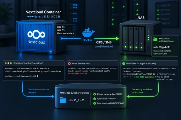

Infographic showing a Nextcloud Docker container using a CIFS/SMB NAS share with matching www-data permissions.

The deployment described by XDA Developers used a Debian homelab server, Portainer, and a Docker Compose configuration. Nextcloud’s bulk storage lived on a NAS, exposed through a Docker-managed volume using the local driver and the cifs filesystem type. CIFS is the name used in the Linux mount configuration for accessing the SMB network share.
According to XDA Developers, Nextcloud started, but its browser-based first-run setup could not create or write to its data directory. Meanwhile, Jellyfin and Immich were already working with storage on the same NAS. Creating a file from the Debian host as root also succeeded.
Those observations made the NAS look healthy, but they answered narrower questions than the operator initially assumed. The host test demonstrated that the tested path was writable by the account performing that test. The other applications demonstrated that their own storage arrangements worked. Neither observation established that Nextcloud’s application account could write to its configured data directory.
That is the central diagnostic value of this incident. “The share is writable” needs an accompanying identity and path to be useful. A successful test performed by one account cannot, on its own, explain a failure encountered by another.
This remains a single-operator account published by XDA Developers, rather than an independently reproduced investigation. Its reported resolution is useful as a configuration-specific example; it does not establish the cause of every Nextcloud data-directory error.
The Compose change targeted mount ownership rather than the NAS account​
The operator’s troubleshooting initially concentrated on the storage rather than Nextcloud’s account. According to XDA Developers, repeated chown and chmod changes on the mounted data directory did not resolve the problem. The operator also experimented with file_mode, dir_mode, and noperm, redeploying between attempts, before resetting the SMB user’s permissions and rotating the volume’s credentials.
The decisive check was:
docker exec nextcloud id www-data
Here, nextcloud was the container name in the reported deployment, and www-data was the account being examined. XDA Developers reports that the result identified that account with user ID 33 and group ID 33. The host-side tests, by contrast, had been performed as root, whose user ID was 0.
The successful edit added these two options to the existing comma-separated o: mount-options value in the Compose volume definition:
uid=33,gid=33
The number appeared twice because the configuration specified both a user ID and a group ID. According to XDA Developers, after redeployment the operator verified the resulting ownership and permissions, then completed Nextcloud’s browser-based setup without the previous error.
The practical distinction is between the application’s local numeric identity and the account used to access the NAS. In the reported deployment, changing the mount’s ownership presentation resolved the failure without a further NAS-side permissions change. It would be an overreach to conclude that the same edit can repair an invalid SMB password or an account that lacks permission on the server.
It would also be an overreach to turn the report into a blanket rule that ownership changes never work on CIFS. The evidence here establishes that the attempted ownership and mode changes did not fix this particular configuration, while explicitly supplying the matching mount IDs did. That narrower conclusion is sufficient to guide a better investigation.
