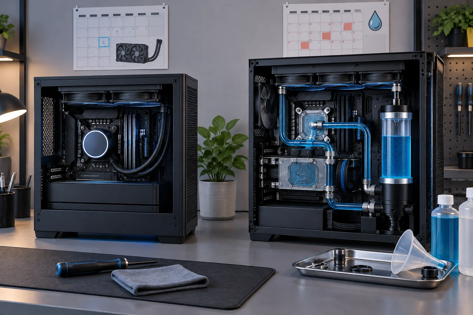

Two desktop PCs sit open on a workbench, one featuring an elaborate blue liquid-cooling system.

Two desktop PCs sit open on a workbench, one featuring an elaborate blue liquid-cooling system. AIO coolers: the coolant isn't your job​
