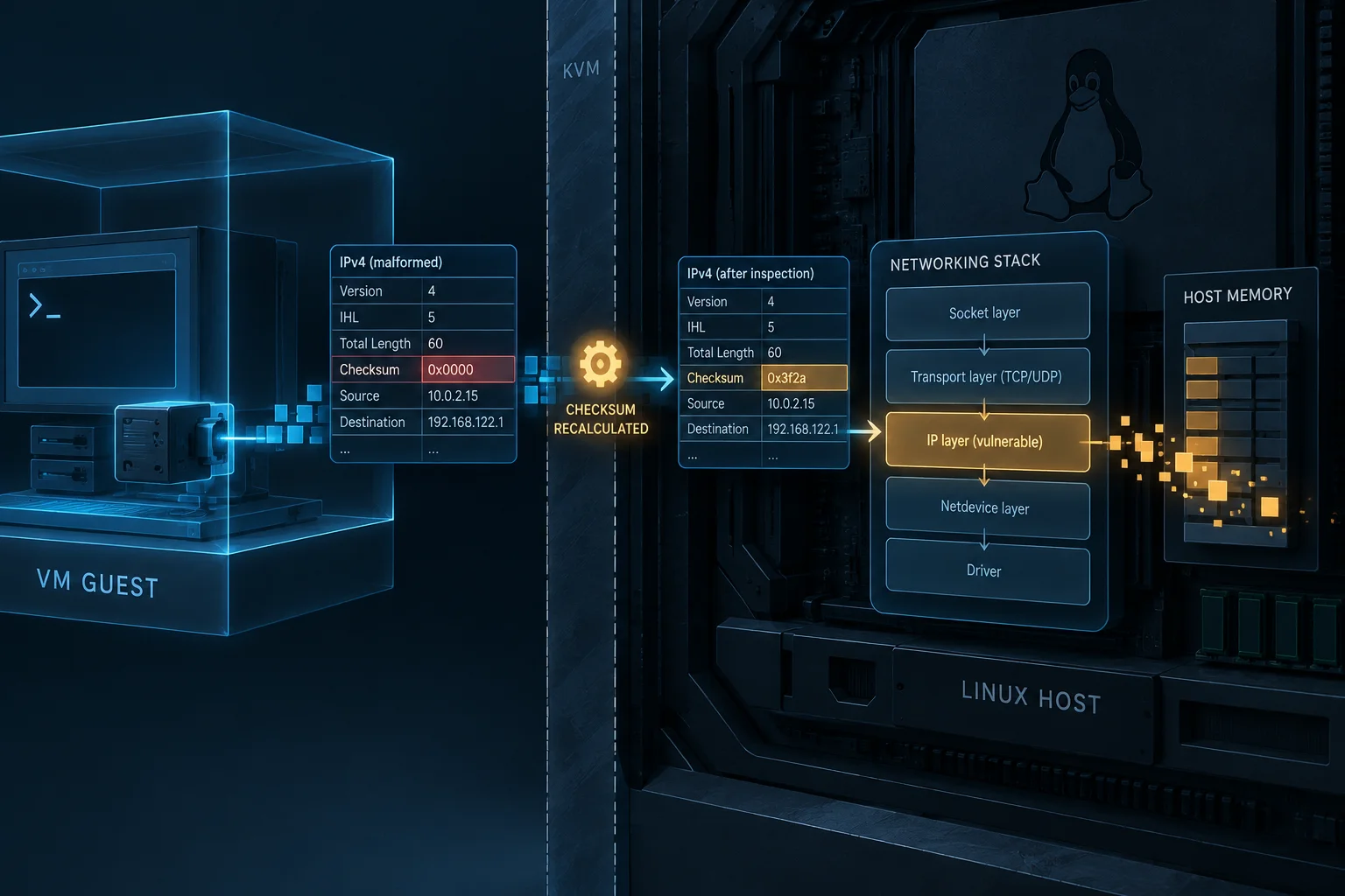

Diagram shows a malformed IPv4 packet’s checksum being recalculated as it passes through a vulnerable Linux host networking stack.

Diagram shows a malformed IPv4 packet’s checksum being recalculated as it passes through a vulnerable Linux host networking stack. What PwnEscape Actually Breaks: Host Networking vs. KVM​
