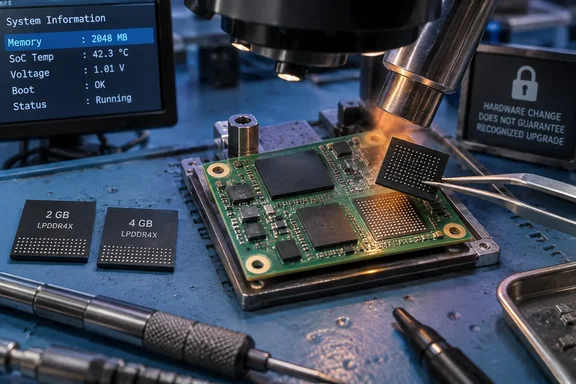

A technician uses a microscope to replace a memory chip on a circuit board.

According to Notebookcheck, a user replaced the soldered memory on a 2 GB Raspberry Pi Compute Module 5, or CM5, with a known-good 4 GB chip taken from another CM5. The system nevertheless continued to report its original capacity. Raspberry Pi engineer and forum moderator PhilE explained that the restriction was intentional, rather than simply an unexplained failure to detect the replacement.
This is already a specialist operation. The memory package is soldered directly to the board, and replacing it requires BGA rework: removing and fitting a package whose solder connections sit beneath the chip. It is substantially different from inserting a memory module into a desktop PC’s DIMM socket.
The important finding is therefore narrower—and more useful—than a blanket claim that Raspberry Pi memory cannot be upgraded. In the reported CM5 case, the physical replacement worked sufficiently for the system to operate, but it did not deliver the expected additional capacity. Hardware rework and acceptance of a different memory configuration are separate hurdles.

That last point is particularly relevant to repair enthusiasts. The reported donor chip was taken from another CM5, not merely purchased as an allegedly compatible loose component. Yet a genuine donor did not make the receiving module behave like the higher-capacity product.
The practical inference is that genuine donor memory does not, by itself, establish an upgrade path. The restriction addresses the receiving device’s accepted configuration, not simply whether the replacement component came from a reputable source.
