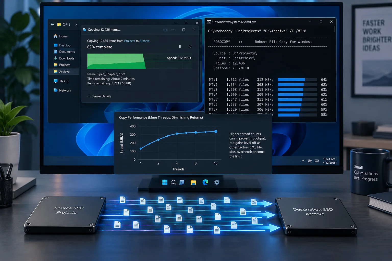

A monitor shows a multithreaded file copy from a source SSD to an archive drive, with progress and performance charts.

A monitor shows a multithreaded file copy from a source SSD to an archive drive, with progress and performance charts. Why 300MB can take longer than 5GB​
