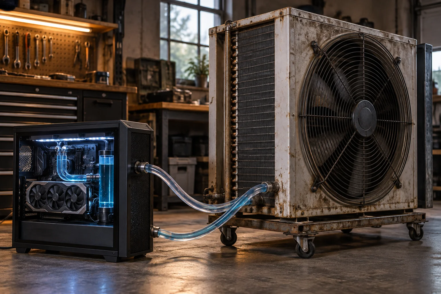

The creator is TrashBench, who is known for unusual GPU and CPU cooling experiments. Rather than using the air conditioner's refrigeration system, he converted the outdoor radiator and fan assembly into part of a conventional water-cooling loop. The donor was a used Fujitsu air conditioner radiator, connected to a custom liquid cooling system built for desktop PC components. The headline numbers are striking, but the coverage doesn't agree on them.
What was built
Tom's Hardware describes an old 4-kW outdoor radiator-fan unit from a split air-conditioning setup, minus the gas, hooked up to a water-cooling loop. TrashBench only needed the radiator, fan and pump. Most of the internals came out, casters were added, and a standard reservoir went into the main enclosure. Tom's Hardware also reports that he modified a T-joint into a Y-joint and 3D-printed brackets to mount the cold plates. I couldn't confirm those construction details beyond that report.
