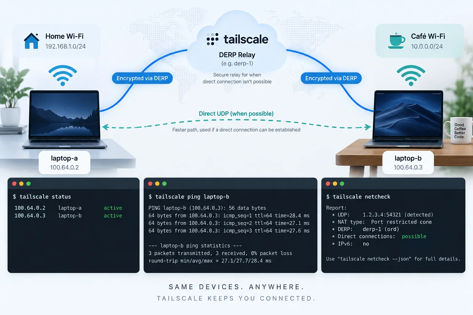

The three connection types
Tailscale's documentation lists three connection types:
- Direct: devices send UDP packets straight to each other.
- DERP relayed: traffic passes through Tailscale's relay servers.
- Peer relay: traffic passes through another device in your tailnet that you've set up as a relay.
All three are end-to-end encrypted with WireGuard. Tailscale says the main difference is performance, not security. Direct connections usually give the lowest latency and highest throughput. Relays are the fallback.

Every connection starts on a relay
Tailscale's docs say all connections start relayed through DERP, and Tailscale then tries to upgrade them to direct. If that fails, it tries a peer relay. If there is none, the connection stays on DERP. Tailscale also periodically re-checks whether a better path is available.
So seeing a relay for a moment is normal. Seeing one that never goes away is the thing to investigate.
How to check your own connections
- Run
tailscale statuswhile the two devices are talking. Look at the peer's line. Tailscale's documentation saysdirectfollowed by an address means a direct connection.relayfollowed by a location code, such as "sea" or "tor", means DERP.peer-relaymeans a peer relay. If there is no relay entry for that peer, the traffic isn't going through DERP. - Run
tailscale ping <device-name>. Read the route in each reply. A reply that saysvia DERP(...)is relayed. A reply that saysvia <address>:<port>is direct. Tailscale's troubleshooting guide says the command keeps trying until it sends 10 pings through relays or finds a direct path. A few relayed replies followed by a direct one is the normal pattern. A relay on every reply, ending in "direct connection not established", is the case to dig into. - Run
tailscale netcheck. Its output includes whether the device supports UDP or port mapping, plus latency to the nearest DERP servers. Tailscale's device connectivity docs describe a field calledMappingVariesByDestIPas the most important field for working out why a device isn't using direct connections. - Test from another network. Move one device to a phone hotspot, or compare home against office or café Wi-Fi, and repeat the ping. If the route changes with the network, the network is your lead.

Why a network forces a relay
Tailscale's documentation names two common blockers:
- Blocked UDP. Direct connections need UDP in both directions. If a network blocks it, devices can still connect through a relay, but not directly.
- Hard NAT. This means a gateway that gives each outbound connection its own port mapping, with an external port that outsiders can't predict. Tailscale says it can't establish a direct connection if both devices are behind hard NAT. Cloud NAT gateways, such as AWS's, can behave the same way.
Both ends matter. The network conditions and NAT types on both sides of a connection decide whether Tailscale goes direct or relayed.
