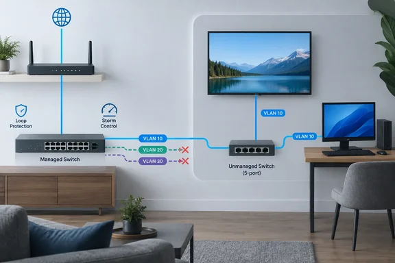

Diagram showing a managed switch passing VLAN 10 through an unmanaged switch to devices, while VLANs 20 and 30 are blocked.

The fix: configure the uplink port​
Nearly everything above gets fixed at the managed-switch port, not in the room:
  1. Set the uplink to access mode (or "untagged member of one VLAN" in HP/Aruba-style interfaces).
  2. Choose the VLAN deliberately. Never use the management VLAN.
  3. Remove every other VLAN from that port.
  4. Turn on storm control and loop detection where supported.
  5. Review port-security and spanning-tree settings for a downstream switch. If port security is enabled, set its MAC limit for the intended devices using your vendor's guidance. Keep BPDU Guard where it protects an intended edge port; investigate BPDU-triggered shutdowns rather than disabling the guard as a routine fix. Don't disable spanning tree across the network.
  6. Test EEE by turning it off on the managed side if links flap.
  7. Check the result. A device on the unmanaged switch should get a DHCP address from the intended VLAN's subnet and shouldn't be able to reach the switch admin interface.
