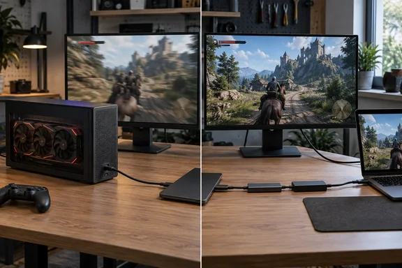

A gaming setup compares a desktop graphics enclosure with a laptop connected to an external monitor, both running a fantasy game.

  • Thunderbolt 3 enclosure: a fairly ordinary Thunderbolt 3 eGPU enclosure from Acasis that uses Intel's JHL7440 chipset, also known as Titan Ridge.
  • DIY USB4 build: an Oculink-to-USB4 adapter built on a Minisforum DEG1. The DEG1's Oculink cable runs to an M.2-to-Oculink adapter, which plugs into a 40Gbps UGREEN M.2-to-USB-C adapter. Saha admits it's "a lot of hoops."
  • Controller: The DIY build uses ASMedia's ASM2464PD chipset, which is much newer than the JHL7440.
  • GPU: an RX 9070 (non-XT) taken from his AM4 desktop.
Summary: One side is a 2018-era Intel Thunderbolt 3 bridge in a finished enclosure. The other is a newer ASMedia USB4 bridge at the end of a chain of adapters.
