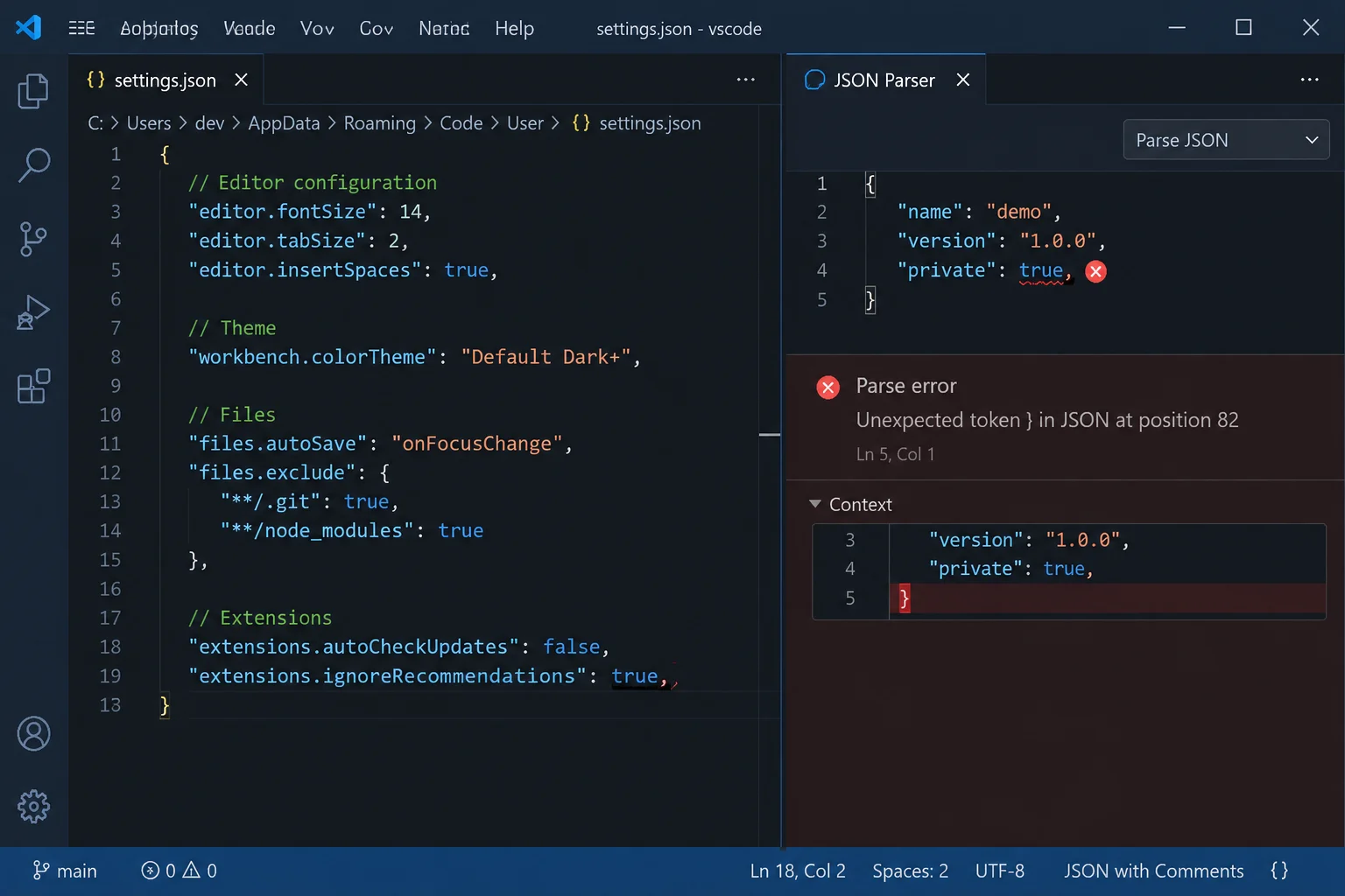

VS Code shows settings.json beside a JSON parser reporting an unexpected closing brace error.
Your settings.json can be full of // notes and trailing commas, and VS Code won't complain. Hand the same file to Python's JSON parser and it fails on the first comment. The behaviour is intentional, and it comes down to a language mode that most developers never think about.
VS Code shows settings.json beside a JSON parser reporting an unexpected closing brace error. The short version​

The status bar at the bottom right shows the active language mode. Selecting the mode indicator lets you change the mode and configure how file extensions are associated with modes.
To get comments in a file that VS Code treats as strict JSON:
  1. Open the file and click the language indicator (it reads JSON).
  2. Choose the option to change the language mode and pick JSON with Comments.
  3. For a permanent fix, add a mapping to settings.json. VS Code's documentation says the files.associations setting can associate file names or patterns with jsonc. A pattern such as *.config.json mapped to jsonc is one example.

Changing the mode only silences the editor. As formatarc.com puts it, the file's consumers still decide what they accept. If a strict parser such as JSON.parse or Python's json.loads later reads the file, the runtime error remains, and the comments themselves have to go.
