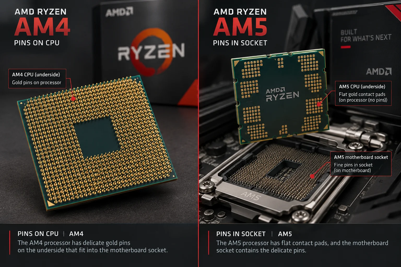

Comparison graphic showing AM4 CPUs with pins versus AM5 CPUs with flat contact pads and pins in the motherboard socket.
Some AMD CPUs still have pins because AM4 and AM5 are two different socket designs, and each puts the fragile contacts in a different place. AM4 processors carry the pins. AM5 processors are flat, and the pins sit in the motherboard socket.
Comparison graphic showing AM4 CPUs with pins versus AM5 CPUs with flat contact pads and pins in the motherboard socket. PGA vs. LGA: where the pins are​
Both designs make the same electrical connection between processor and motherboard. What differs is which part carries the delicate metal.
  • AM4 (PGA, pin grid array): The pins are small metal spikes on the underside of the CPU, exposed and vulnerable as soon as you pick the chip up. One guide puts the count at 1,331 pins.
  • AM5 (LGA, land grid array): The pins live inside the motherboard socket, and the CPU has flat gold contact pads instead. The socket is LGA 1718, with 1,718 contacts.
AMD launched AM5 with Ryzen 7000 on September 27, 2022, after announcing it on August 29, 2022. Tom's Hardware noted at the time that AM5 was AMD's first move to LGA on its mainstream platform, after using PGA for ages. AMD had already used LGA on higher-end parts. Socket TR4 was its first consumer LGA socket, for Ryzen Threadripper.
So the headline's premise is slightly off. AMD's mainstream desktop chips moved away from pins. The pinned chips you can still buy are AM4-era parts.

  • AM4 puts pins on the CPU, so the processor is the fragile part.
  • AM5 puts them in the motherboard socket, so the board is the fragile part.
