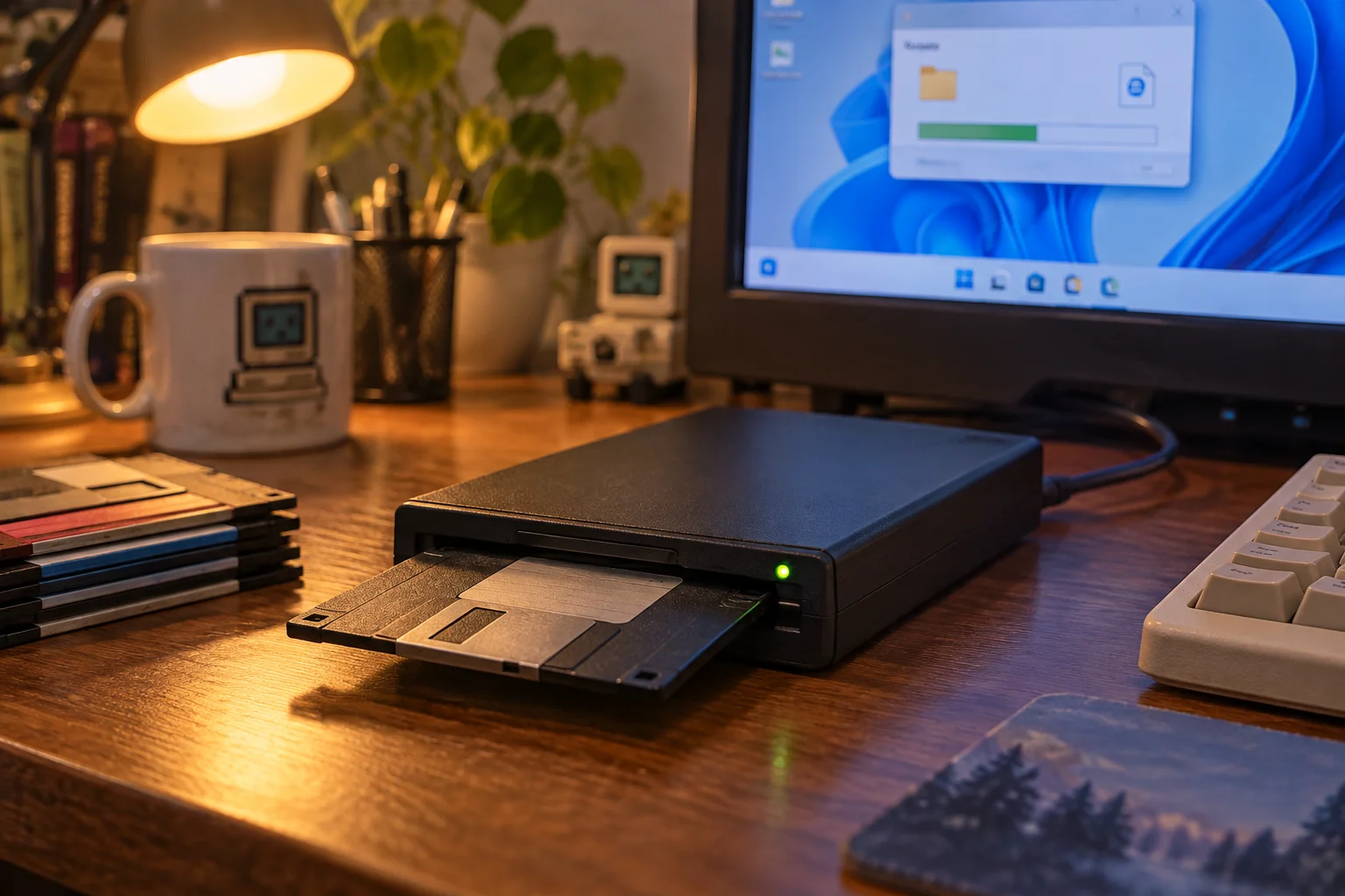

Quirk one: the noise
Heinzman compares a working floppy drive to a box of angry cats. He says it churns and whirs as if it's on its last breath, and that a failing drive adds clicking on top. He also notes an upside: you can hear exactly when the drive is reading or writing, which modern SSDs don't tell you. He points out that his drive is a cheap plastic external unit, and that one inside a desktop tower would probably sound more muffled.
That is one person's account of one drive. It is not a diagnostic standard. Still, the source of the racket is mechanical and well documented. A Siemens floppy drive maintenance manual describes a head positioned by a stepping motor and lead screw. A separate Siemens manual says the stepper turns in one direction to move the head outward toward the disk edge and the other way to move it inward. The sounds you hear are largely that mechanism moving the head from track to track.

Quirk two: the ejection
Heinzman says his Looney Tunes screen saver disk shot out of his cheap drive when he pressed eject, like a foam dart. He believes most floppy drives, perhaps all, use a spring-loaded mechanism to lock in and eject disks. He says that how you position your hand affects how hard the disk launches. He also acknowledges that some drives eject gently and others aggressively, and that it's a minor matter because the disk's plastic shell protects the media.
The "projectile" behavior is best treated as his experience with that particular drive. The spring part, though, has documentary support. A Tandy portable disk drive service manual describes the eject sequence. Pressing the eject button releases the loading plate and click. The disk holder spring and a second spring then push the disk out.
Practical advice, drawn from his experience rather than any standard:
- Keep a finger or palm near the slot when you press eject.
- Don't aim the drive at anything fragile, such as a coffee mug or your monitor.
- Remember that the shell protects the disk when it lands, but not the disk's sliding shutter from a hard hit on a tile floor. That one is my own caution, not a sourced claim.

The "USB is 20% slower" claim
Heinzman writes that some sources say USB floppy drives run about 20% slower than traditional drives because of the packet conversion. I couldn't find corroboration for that figure, and none of the documentation reviewed establishes it. Treat it as an unverified claim. If your USB drive feels slower, the drive, the software and the workload are all better suspects.
For context, the Toshiba manual describes its drive's USB link as full speed, 12 Mbit/s. That is far above the floppy's media rate, so the interface is unlikely to be the main bottleneck. That is my inference, not a measured result.
