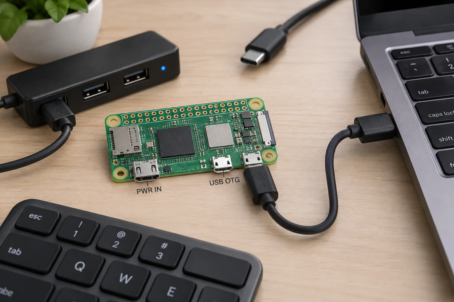

A small single-board computer is connected to a laptop and USB hub on a wooden desk.

A small single-board computer is connected to a laptop and USB hub on a wooden desk. What the Pi Zero actually has​
Raspberry Pi's own documentation describes the Zero 2 W as having two micro USB ports: one for input power, and one for USB On-The-Go (OTG), compatible with adapters for keyboards, mice, hubs and other external devices. The original Zero W uses the same arrangement. Raspberry Pi's product page describes the Zero 2 W the same way: like the original Zero, it has a mini HDMI port, a micro USB port, and a micro USB power port.
This corrects one simplification in the popular framing. The idea that USB on these boards is mostly for diagnostics, if used at all, doesn't hold up. The Zero's data port is a real OTG port, and for many users it is the only way to attach anything.

  • Know your ports. The port nearest the outer edge, labeled PWR IN, is power only. The one closest to the mini HDMI is the USB/OTG data port. Third-party troubleshooting guides report that a mouse LED lighting up with no response usually means a device was plugged into the power-only port.
  • Use a real data cable for gadget mode. A Raspberry Pi forum thread advises a proper data cable on the OTG port, with nothing on the power port. If you use an OTG adapter, make sure it pulls the ID pin correctly. Otherwise the board may stay stuck in device mode.
