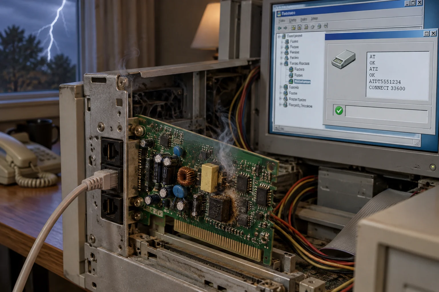

A smoking computer circuit board sits open beside a diagnostic screen as lightning flashes outside.
A reader's tale from The Register's "On Call" column shows how a Windows modem test can pass while the hardware is damaged. It's a good reminder that a clean software result doesn't mean a healthy device. It's also a fun story: a dial-up modem, a senior exec, an essay-writing side hustle and a lightning storm.
A smoking computer circuit board sits open beside a diagnostic screen as lightning flashes outside. The story as The Register tells it​

  3. He opened the modem's properties in Windows Device Manager. He used the advanced option that sends low-level AT commands to the modem and reads its responses.
  4. Windows reported the modem as healthy.
He then decided to replace the modem anyway. When he opened the PC, he caught a faint scorched-circuit-board smell. He also saw a black soot mark where the modem's line-protection chip sat, between the phone line and the sensitive chips. In his words, the chip had been vaporized.
He asked the executive when the email had stopped working and whether there had been any storms. The executive said it stopped while he was watching an impressive lightning display. Lachlan's verdict was that the chip "sacrificed itself for the greater good."

This isn't a case of Windows lying. In the Windows versions of that era, the modem's Diagnostics tab had a "Query Modem" button. The steps were: open Device Manager, expand Modems, open the modem's properties, click the Diagnostics tab and click Query Modem. Clicking the button returns responses from the modem.
A TechRepublic walkthrough says the button sends the same AT commands to the modem that you could type by hand in HyperTerminal. A Dynabook support page says that if the window lists AT command responses, the modem is correctly installed.
Those descriptions share a limit. The test confirms that the operating system can talk to the modem and get answers. It doesn't confirm that the modem can complete a call. Anyone who has seen a printer answer every status query and still jam on page one will understand.
The same sources show where the line sits. A Windows XP administration guide describes the test as a way to scroll through the output and look for errors. A community answer on a help forum says populated Command and Response columns mean the modem is "probably working." Both are cautious, and the caution is justified. A Dell diagnostic utility went further and tested for a dial tone, which suggests the vendor knew that talking to the modem is a separate matter from dialing out.
I can't tell from the column what Lachlan's modem still did after the damage. A modem's command-processing side can plausibly keep answering while the line-interface side is dead. That is an inference from how modems are built, not something the column establishes.
