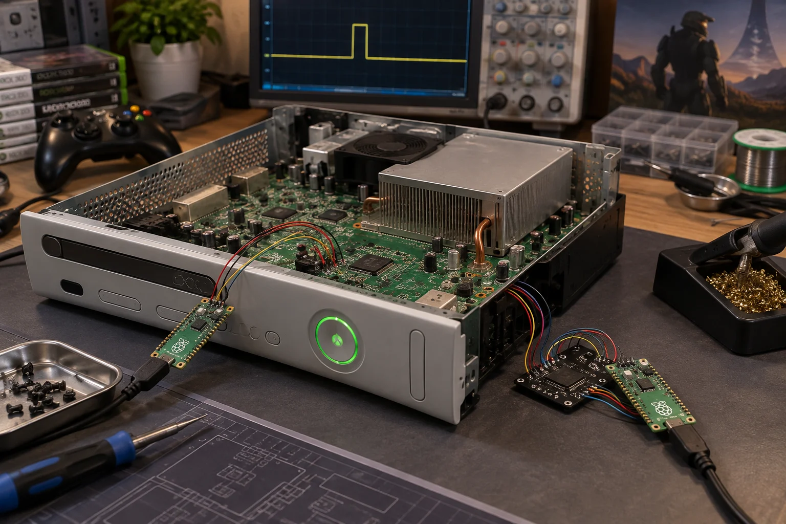

A Scottish modder just closed out a project that sat on a shelf for nine years, and it neatly shows how hardware attacks on Microsoft's old console have changed. Kennedn, the author of the kennedn.com blog, is identified by Tom's Hardware as Joshua Kennedy. He bought a Matrix CoolRunner Rev D glitcher in 2017 and only finished the Xbox 360 hack in 2026. He did it with two Raspberry Pi Pico boards. He did not discover a new exploit, and the Pico didn't "hack" anything alone. He completed a personal mod using an established hardware technique. The cheaper tools just made the job possible.

If the lock is sound, attack the hardware's assumptions. Computation depends on stable electrical conditions. Researchers found that briefly toggling the CPU's reset line (CPU_RESET) does something unexpected. The CPU doesn't reset. It executes the current instruction incorrectly.
The glitcher's pulse lasts roughly 100 nanoseconds. That was enough to corrupt the mr (move register) instruction in the signature-verification path. The faulted instruction moves a zero into its destination register instead of the intended value. Kennedn's summary is that once you know when to flick the lights, you get arbitrary code execution.

In 2026 he split the work between two Picos:
  1. NAND dump. He flashed PicoFlasher onto a Pico and soldered it to the correct pads on the console. The dump then took "a handful of seconds." He gives no exact time or NAND size.
  2. Glitcher programming. He flashed Pico-dirtyJTAG onto a second Pico. He used it to program the CoolRunner's timing files, using Octal450's timing files and urJTAG built from source.
The two steps are different jobs. The first reads the console's flash. The second loads timing data into the modchip.
