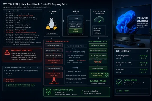

Infographic explains a Linux ARM CPU frequency driver double-free bug, its fix, and secure package update.The faulty free occurs during Qualcomm CPU-frequency teardown​
