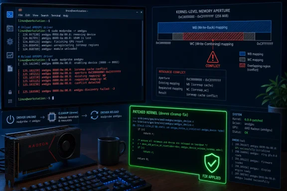

A Linux workstation shows an AMDGPU ioremap conflict, kernel patch, and successful driver initialization.The cleanup path was unreachable by design​

The documented failure mode is most specific on AMD hardware where the GPU is marked
connected_to_cpu
, an XGMI-oriented configuration in which the GPU aperture can correspond to system RAM. Before the fix, AMDGPU mapped that aperture with
ioremap_cache()
, giving it a write-back, or WB, cache policy.
On a subsequent probe, AMDGPU’s IP-discovery path attempts to map the same physical range through
memremap()
using a write-combining, or WC, policy. Linux refuses to create the second mapping because the earlier WB mapping is still live in PAT metadata. The kernel is enforcing cache-attribute consistency, but the driver’s missed cleanup leaves it with no valid way forward.
The resulting diagnostic is unusually revealing:
Code:
ioremap error for 0x..., requested 0x1, got 0x0
amdgpu: discovery failed: -2
The
-2
value corresponds to
ENOENT
, but the operative failure is not that a device has vanished from PCIe. AMDGPU’s discovery sequence cannot establish the memory mapping it requires, so initialization stops. This can look like a failed driver probe after a module reload even though the GPU itself remains present.
For workstation administrators, this separates CVE-2026-68102 from the much broader class of AMDGPU ring timeouts, display engine failures, and game-related GPU resets. Updating for this CVE is sensible, but it should not be sold as a universal remedy for every
amdgpu
crash or black-screen report. The specific breadcrumb is an aperture mapping conflict during a post-unload reload.
