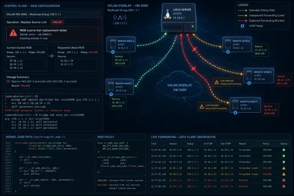

VXLAN dashboard shows a failed MDB policy replacement, forwarding leaks, and blocked traffic across VTEPs.A replacement error was not atomic​

The defect was in its rollback. If adding the replacement list failed partway through,
vxlan_mdb_remote_srcs_add()
deleted every source entry associated with the remote. That cleanup made sense when the same helper was called while creating a new remote entry: in that case, every source on the list had been created during that one operation.
It was wrong during replacement. Existing sources and newly added sources shared the same list, so the failure path removed pre-existing entries along with the incomplete replacement. The command failed, but the forwarding state did not revert to what it was before the command began.
That is the central consequence of CVE-2026-68116: it violates a basic expectation of network configuration tooling. An unsuccessful replace should preserve the old state. On affected kernels, it could instead delete it.

The kernel advisory spells out the two failure modes. If an EXCLUDE entry loses source records after a failed replace, traffic from sources that should have been blocked can begin forwarding. If an INCLUDE entry loses source records, traffic that should have been allowed can be dropped.
Those are very different incidents in practice:
  • An EXCLUDE-policy failure can defeat a deliberate isolation or suppression rule, causing multicast traffic to traverse an overlay where operators expected it to be denied.
  • An INCLUDE-policy failure can interrupt applications that rely on tightly scoped multicast delivery, such as clustered services, broadcast-discovery domains, media distribution, or specialized industrial and lab networks.
This is not described as a memory-safety issue, privilege escalation, or kernel crash. It is a forwarding-integrity flaw: a bad outcome from a failed administrative operation can persist in the data plane. That means monitoring only the exit status of an automation job is insufficient. A controller may record a failed update while the network is already forwarding according to neither the old policy nor the requested new policy.
