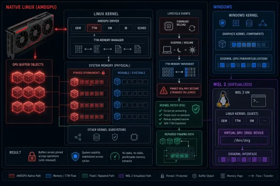

Infographic comparing native AMDGPU Linux memory management with Windows and virtualized WSL2 GPU paths.

The affected routine, amdgpu_bo_create_reserved(), is intended to create a reserved buffer object—known in the driver as a BO—for kernel use. It accepts a pointer to an existing BO pointer. If that pointer is null, the function creates the buffer; if it already points to a buffer, creation is skipped.
The problem was that the old code did not similarly distinguish between creating a BO and pinning one. It skipped allocation when a BO already existed, but still reserved, pinned, allocated GART backing for, and mapped that same existing object. Each subsequent call added another pin reference.
Pinning is a memory-management constraint rather than a simple bookkeeping flag. A pinned BO is not freely relocatable by the TTM memory manager, the Linux subsystem that manages GPU memory placement and eviction. The matching teardown path, however, unpinned only once. After repeated reuse, the pin count could never return to zero, leaving the object effectively stuck in place.
The kernel.org advisory specifically identifies firmware buffers stored on the AMDGPU device structure as an example. Those buffers can be reloaded during resume, cp_resume, or driver start paths when AMDGPU_FW_LOAD_DIRECT is in use. A machine that repeatedly suspends and resumes, or repeatedly reinitializes the relevant GPU firmware path, is therefore more exposed to the leak than a system that boots once and remains up.
This is also why the bug is more serious than a small counter imbalance. The leaked pin references can stop TTM from reclaiming memory that it would normally be able to move, swap, or evict. Over time, that can turn a recoverable driver-memory allocation into a persistent pressure point for the graphics stack.

For ordinary Windows 10 and Windows 11 installations, CVE-2026-68234 does not apply to AMD Software: Adrenalin Edition, the Windows AMD display miniport driver, or the Windows DirectX kernel graphics subsystem. This is a Linux kernel AMDGPU source-tree defect. Updating a Windows Radeon driver will not add the Linux patch, and applying a Linux kernel update will not alter the Windows display driver.
The Windows-specific question is WSL 2. WSL 2 does run a genuine Linux kernel in a lightweight virtual machine, so kernel CVEs can matter to Windows users. But this particular issue has a narrower scope than the product name suggests.
Microsoft documents that WSL GPU access is routed through the /dev/dxg device to the Windows GPU stack. In the standard WSL 2 GPU-acceleration model, an AMD Radeon card used for DirectML, Linux GUI acceleration, or supported compute work is exposed through that virtualization path rather than being driven as a physical PCI device by the Linux amdgpu kernel driver. A Windows user running GPU-accelerated workloads in WSL should therefore not assume that use of an AMD GPU means the vulnerable AMDGPU code is active.

But for this CVE, the relevant question is whether the WSL kernel is actually booting and binding the Linux AMDGPU driver to hardware. On a conventional WSL 2 installation, the answer is generally no: the graphics route is /dev/dxg, not native AMDGPU device management. The more plausible Windows-adjacent cases are custom WSL kernels, nonstandard virtualization arrangements, Linux dual-boot installations, or Hyper-V/Linux guests with direct GPU assignment.
