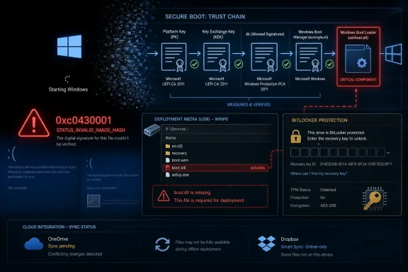

boot.stl, WinPE images, and error code 0xc0430001.If installation media has been updated without including the correct
boot.stl file, Microsoft warns that devices might fail to start from that media and can throw 0xc0430001. That does not prove every reported blue screen is Microsoft’s fault, HP’s fault, or an administrator’s imaging problem. It does show that this month’s update touches an area where a missing file or stale deployment image can turn a routine servicing task into a recovery-room exercise.HP Reports Point to the Fragility of the Boot Chain

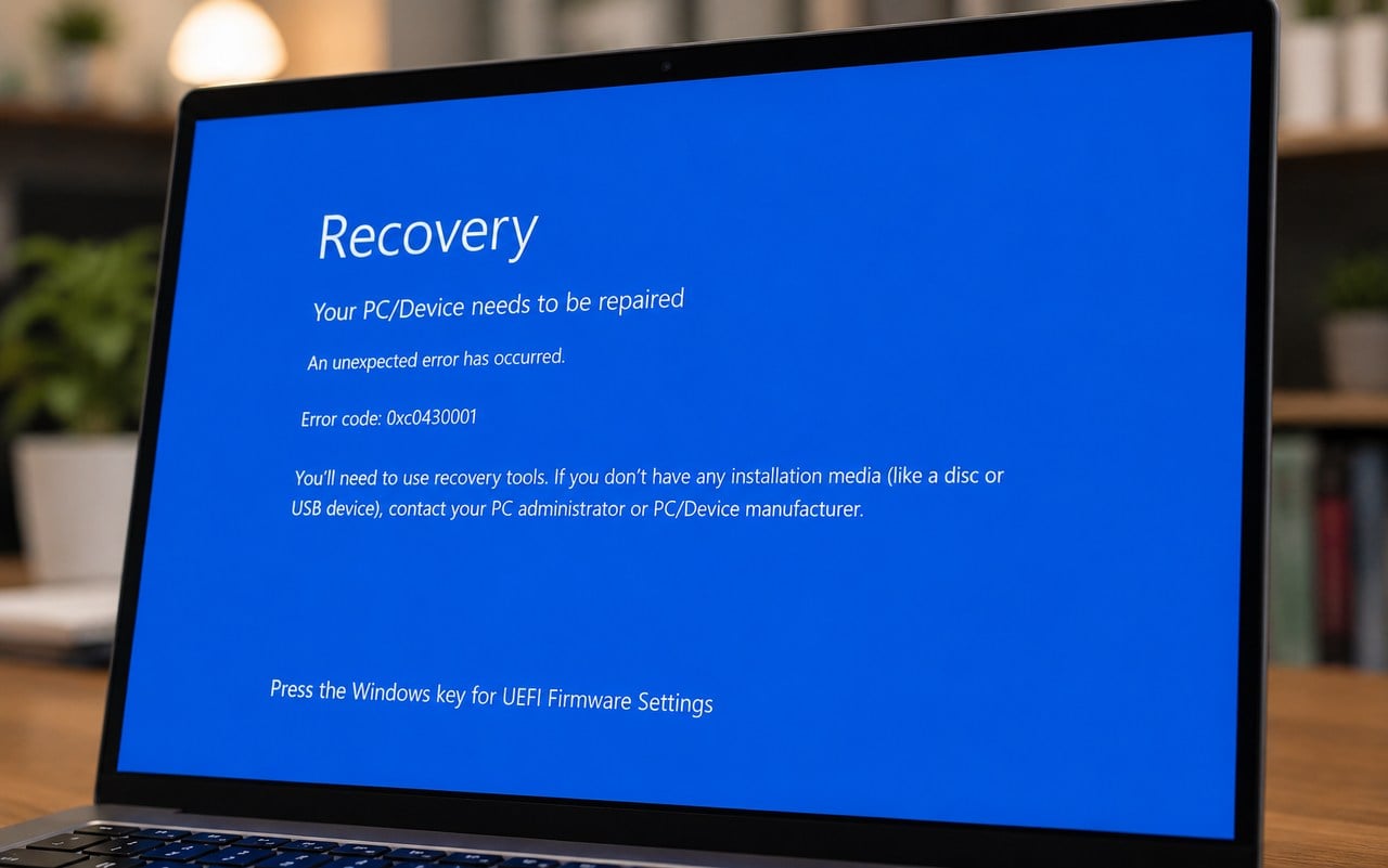

The loudest reports so far appear to involve HP systems that hit a 0xc0430001 blue screen after KB5094126. Users on sysadmin and support forums have described machines refusing to boot cleanly, and in some cases failing even when administrators attempt recovery or reinstallation from media. The common thread is not simply “Windows update broke my PC,” but a more specific collision between Secure Boot validation and the files used to prove that Windows boot components are trusted.That distinction is important. A blue screen during normal Windows operation usually sends troubleshooting toward drivers, memory, virtualization, graphics, or storage. A blue screen tied to Secure Boot validation sends the investigation much earlier in the startup sequence. At that point, Windows is not merely loading an operating system; firmware, boot manager, certificates, and platform trust settings are all part of the same decision.
The
boot.stl file has become the symbol of this mess because Microsoft explicitly calls it out in the KB5094126 deployment section. The file is used during Secure Boot validation and must match the Windows version and architecture being deployed. Copying a similar-looking file from another image is not good enough if the architecture or release level does not match.That guidance also helps explain why the issue may look scattered rather than universal. A consumer laptop receiving KB5094126 through Windows Update is not the same scenario as a managed fleet using customized installation media, offline servicing, task sequences, or recovery USB drives that have accumulated months of partial maintenance. The same cumulative update can behave very differently depending on the age of the image used to deploy or repair the system.
HP may be overrepresented because of hardware population, firmware behavior, enterprise fleet composition, or simply because more administrators with HP devices are comparing notes. Without Microsoft or HP publishing a confirmed defect statement, it would be irresponsible to declare a single root cause. But the pattern is serious enough that administrators should treat HP boot failures after KB5094126 as more than anecdotal noise.

For users, that distinction may feel academic. A machine that will not boot after Patch Tuesday is a broken machine, no matter which bucket Redmond puts it in. But for IT teams, the distinction matters because it changes the remediation path. If the problem is a bad update, you wait for a rollback, out-of-band patch, or vendor advisory. If the problem is stale deployment media, the fix may be in your imaging pipeline.
Microsoft recommends using the Update WinPE script to update existing Windows images so the required Secure Boot files are included. The manual alternative is to copy
boot.stl from Windows\Boot\EFI on a working installation into the corresponding folder on the installation media. That advice is precise, but it also assumes a level of deployment discipline that many smaller shops do not have.The result is a predictable split. Large enterprises with mature imaging processes will verify boot media, refresh WinPE, and test representative models. Small businesses and power users may discover the issue only when their “known good” USB recovery drive fails at the worst possible moment. That is where Microsoft’s technically accurate note still feels operationally thin.
