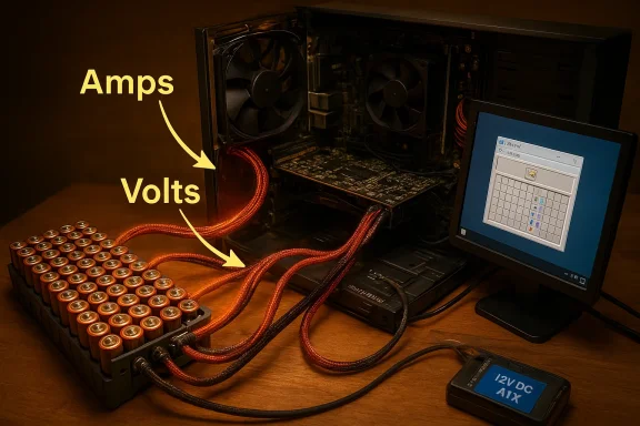

An open desktop PC connected to a battery bank via red cables, labeled amps and volts.Background​

ScuffedBits used a modest desktop: an entry‑level Intel CPU, two RAM sticks, a 2.5‑inch SATA SSD, and an old Corsair CX430 (450 W) system as the chassis reference before bypassing the PSU with a DC ATX adapter. The plan: make enough 1.5‑volt AA cells hit ~12 V and provide enough current to keep the motherboard and small GPU components alive. Early attempts with small packs failed; after switching from carbon‑zinc to alkaline cells, thickening the cabling, and adding capacitor buffers, he reached a configuration using 56 AA cells that — briefly — powered the machine.
The hardware and the hacks​
The components you need to know​
  • The desktop: low‑end Intel CPU, 2 DIMMs of RAM, SSD; Windows 10 as the OS (specific CPU and motherboard not disclosed).
  • The original PSU: a CX430 450‑watt ATX supply used as a baseline and to boot in some experiments.
  • The DC adapter: a PicoATX‑style ATX plug that accepts a 12 V DC input and provides the ATX rails expected by a motherboard. These adapters let you feed DC directly to a PC without an AC→DC PSU.
  • The batteries: a mix of carbon‑zinc initially, then alkaline AA cells (56 in the final run). Exact brand/model of AA cells is not fully specified in the coverage, so internal‑resistance assumptions must be handled as ranges.
  • Buffer caps and wiring: two large electrolytic capacitors (reported as a pair of 6,800 µF, 40 V caps in series) plus thicker multi‑wire cabling to reduce voltage sag and equalize current paths.
What ScuffedBits actually did, step by step​
  • Tried eight AAs in series (nominally ~12 V) and discovered the supply collapsed under startup load. The system twitched (fans spun once) then died.
  • Increased cell count and paralleled packs to raise available current, swapped carbon to alkaline cells (higher instantaneous output), but initial wiring and thin leads continued to bottleneck current delivery.
  • Upgraded wiring and added large capacitors to buffer startup inrush, then booted the machine from the CX430 and switched to AA power once Windows was loaded. That produced short, functional runs.
