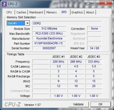

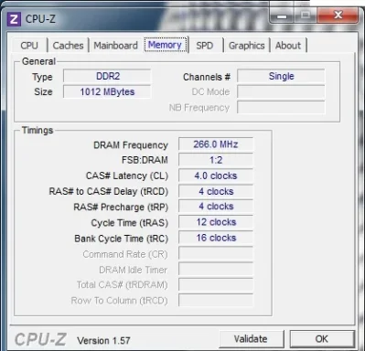

the netbook has 512mb built into the mobo and then a single slot for expansion, only 1 shows in spd which im guessing is the expansion one.
attatched are the 2 screenshots of cpuz and 2 bsod dumps.
any help would be much appreciated :)

1. Your RAM is currently running 133mhz underclock at 533mhz 4 4 4 12. Which is not a good idea.
Correct rates are 667Mhz 5 5 5 15 1.8v
How to set memory right? In the bios.

unfortunately the designers of this netbook decided that if people wanted to add extra ram they wouldnt want to check that it is at the correct frequencies/timings, so i cannot change that unfortunately. I guess i will have to remove the ram and see if there is another stick that will automatically be set at the correct settings. Thanks also for the links to the drivers!
Out of interest how did you find which drivers were out of date? I assume you didnt go through one by one and look it up :p
many thanks for your help!
EDIT: also on the acer page i linked to it says 533Mhz so i guess thats why it set the additional stick at that speed too. Do you think i should try with the ram removed? although win7 with 52mb ram on a netbook is going to suck pretty hard lol =/
i guess i could try one of the sticks suggested here: Link Removed due to 404 Error, there is one that is 533mhz which would match the internal ram, although i didnt think it would matter too much as long as the faster ram supported the lower clocks, which according to cpu-z the one i have in does :S

That could be another causer of your crashes, in case the extra stick you've added is not matching with the others.
Passmark RAMMon tool could clarify this. Save your report as HTML, zip, and attach.

here you go, again it looks like it only shows the extra ram stick not the integrated
  • RAMMon - SPD Info.zip
Rammon report shows you have only 1 Hynix DDR667 in slot #2. The cpuz screenshots that you attached earlier show 1 512 Mb stick in slot #1 and the total amount of ram being 1012 Mb.
- In the bios, look for an option to load setup defaults
run 10 passes of memory test Memtest86+ - Advanced Memory Diagnostic Tool
- a good idea to buy new set of matching sticks recommended for this certain type of motherboard. For example, if your motherboard has no support for ddr800, do not buy ddr800. Do not install side by side ddd533 and ddr667, as it won't work well. Sticks should be identical sold in a kit.
