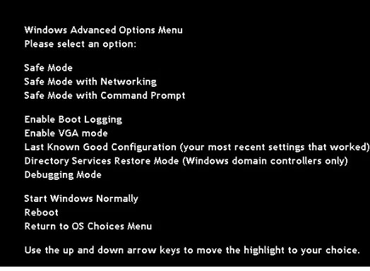

Try F2 instead of F8, or unlock F keys on your keyboard if there's such switch on it.
#7
i don't have anything locking my f-keys.
and i CAN get into boot menu... and then it shows me a boot first devie menu... and since my keyboard doesn't respond there i have to restart again.
I can also get to my bios.
#8
Did you try F2/F8, you need to get to the windows boot menu !

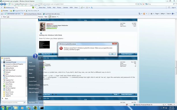

this is what i get when i try to access programs as administrator Untitled.png

same thing happens with msconfig..
it asks for admin password and then says the program can't be found

Run msconfig w/ Admin privileges:
Start => Standard => Command Prompt => Right-Click => Run as admin = > msconfig
or => control userpasswords2
