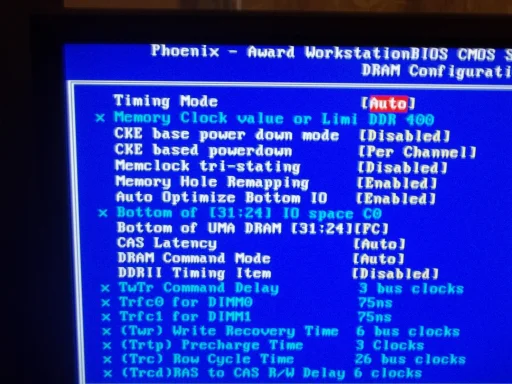

Well I have tried everything I know, thats why I am here is for you help of what are causing all these Blue Screens with various errors. Some times it won't even boot into windows or safe mode, and other times it will get into them but crash soon after. I have ran the built in memory test in windows, I have even tried each memory stick one at at time. I use hard disk sentinal and it doest report any harddrive problems. I don't know if in the logs it will show but it might have my onboard nvidia video device disabled, I did try that too. All of this started after I put in a pci-e ati video card, but since then i have formatted and reloaded windows and I still have the problem so I don't know what is going on. Every time I try to uninstall the nvidia video drivers from control panel it will give me a bsod 0x0000004a which probably isn't in the logs because I already had the logs made before this happened.I then ran driver sweeper and ccleaner to remove it and then it started up in regular mode and stayed on for the longest it had in a long time, then i got this bsod error 0x000000d1 then it mentioned ataport.sys, which also probably isn't in the logs but if you need them I will redo my logs if I can get my computer to stay on long enough. Hope we can get this figured out, I've been trying to figure this out for about 2 weeks. I am using Windows 7 Ultimate x64 and my mainboard is the Biostar MCP6P M2+ Ver. 6.x and I'm using on board video.

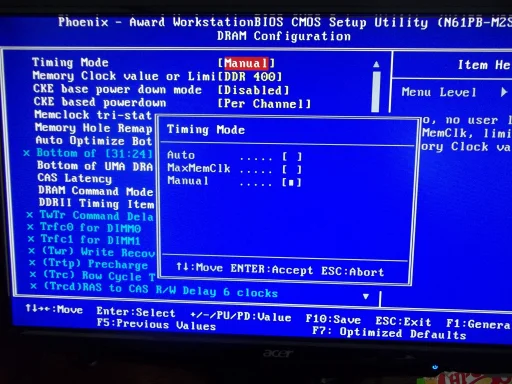

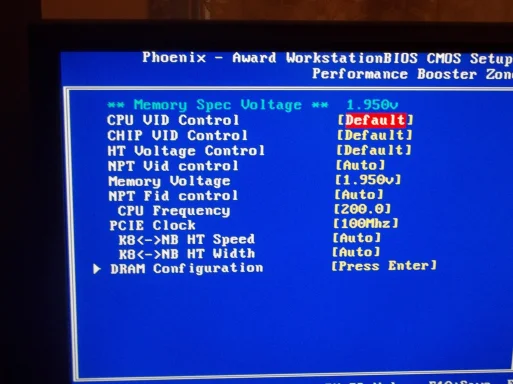

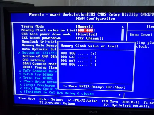

The memory timings are set right 5-5-5-15-20. However, the frequency is not. It is running at 200 Mhz while it should at 333 Mhz. In the bios, set all the DRAM options "Auto".
PC-5300
Frequency: 333 Mhz <- Auto
Timings: 5-5-5-15-20 <- Auto
Voltage: 1.8v <- Auto

just curious but is there anyway to get screenshots of the bios, i know how to do it within windows but not in the bios. Like a lot of those things you mentioned don't have the auto option and like on the voltage it is set on the lowest setting 1.95v. I have uninstalled avast and virtual clone and named BS_I2cIo.sys to .old, will keep you updated. Let me know about any other options,thanks for your help.
#4
With a camera.
They do unless you got some exclusive motherboard. "Auto" will adjust them to the right settings.
#5
ok i will take some pictures, and yeah knew auto would probably do that but, I don't know what everything is under that performance boost section and i don't want to ruin anything so I will post pictures and hopefully you can help me out.
#7
Change them to "Auto":
1. Memory Voltage
2. Memory Clock - I don't see this option in your bios though, there is one in blue but that's not an option.

Ok,
1. Timing Mode --> Auto
2. Memory Clock Value or Limit --> 667 (DDR 333 Mhz x 2)
After you adjust the settings, attach the CPU-Z tabs.
The only way I could get Memory Clock Value or Limit --> 667 was to change timing mode to Manual, I just wanted to mention I did do that and I am trying to still get the cpu-z and logs once I can get windows to stay on long enough to get them ran.
