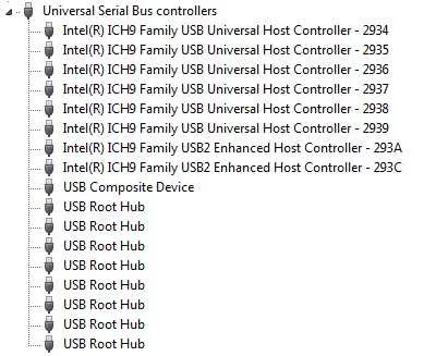

Hi Thanks for the reply..
The device manager shows the following..
It remains the same when I plug a device in...
What I did was to uninstall all the above and the W7 did an auto reinstall on boot up?

#4
So other devices are not working?
If you plug in the USB drive, it will show up in another area. Do you get any messages when you plug it in? Do you know if it installs any of its own software?
#5
No whanever I plug anything in the device manager does not change ..I use a wireless mouse and thats not working also..
The PC used to make a sound to acknowledge a plugged in device..but no more!The USB ports are really "disconnected"/not recognised.
