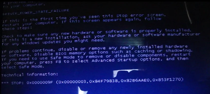

    For a while (ever since I updated my BIOS, I think) my computer have been taking around 10 minutes to shut down and after the 10 minutes it shows a blue screen for a second and then it restarts/shutdown. I recorded the computer screen while it was shutting down and was able to take a screenshot of the blue screen. This is what it says:
    Code:
    DRIVER_POWER_STATE_FAILURE
    If this is the first time you've seen this stop error screen.
    Restart your computer. If this screen appears again follow these steps:
    Check to make sure any new hardware or software or software manufacturer for any windows updates you might need.
    If problems continue, disable or remove any newly installed hardware or software. Disable BIOS memory options such as catching or shadowing. If you need to use Safe Mode to remove or disable components , restart your computer, press F8 to select Advances Startup Options, and then select Safe Mode.
    Technical information:
    *** STOP: 0x0000009F (0x00000003, 0x84F79838, 0x82B6AAE0, 0x853F1270)

    STOP 0x0000009F: DRIVER_POWER_STATE_FAILURE
    Usual causes:
    Device driver
    Your dump files all list ACPI.sys as the probable cause. This is a Windows System file and for it to be the cause of your crash is highly unlikely.
    Old and incompatible drivers can and do cause issues with Windows 7, often giving false error codes. Random stop codes can often indicate hardware issues.
    As a Priority:
    dtsoftbus01.sys Mon Oct 17 13:12:37 2011 The dtsoftbus01.sys driver has been known to cause problems on some Windows 7 systems. This belongs to Daemon Tools Light. I suggest uninstalling DT Light until your blue screens are resolved. But do not replace with Daemon Tools!!
    Drivers that pre-date Windows 7. Update:
    nvlddmkm.sys Fri Mar 06 12:47:34 2009 nVidia Video drivers
    nvmfdx32.sys Fri Aug 01 19:37:49 2008
    nvsmu.sys Mon Aug 25 11:22:50 2008
    • Download and install DriverSweeper.
    • Uninstall your current Graphics setup through Programs and Features
    • Boot to (preferably) Safe Mode and run Driver Sweeper to clean up the remnants of your current Graphics set up.
    • Reboot to Normal Mode.
    • Install your new Graphics set up.
    bcmwl6.sys Wed Jul 08 01:44:47 2009
    bcwl664, Wiki Drivers (01/03/2011).
    CHDRT32.sys Tue Mar 04 18:31:57 2008 Conexant High Definition SmartAudio
    HpqKbFiltr.sys Wed Apr 29 14:46:51 2009 HP Quick Launch Buttons / Keyboard Filter
    HSX_CNXT.sys Wed Jun 20 19:28:20 2007
    HSX_DPV.sys Wed Jun 20 19:29:51 2007
    HSXHWAZL.sys Wed Jun 20 19:28:32 2007
    SoftK56 Modem Drivers. Conexant Systems
    mdmxsdk.sys Mon Jun 19 22:26:59 2006 Conexant Modem Diagnostic Interface x86 Driver
    xaudio.sys Tue Jul 10 22:27:55 2007 Conexant modem audio driver
    iPodDrv.sys Sat Mar 28 01:11:58 2009 doubleTwist iPod Driver
    GEARAspiWDM.sys Mon May 18 13:17:04 2009 Gear Software CD-ROM Class Filter Driver v4.019.1 (Oct 2011). Also loads with iTunes
    Bugcheck Analysis:
    Code:
    *                        Bugcheck Analysis                                    *
    Use !analyze -v to get detailed debugging information.
    BugCheck 9F, {3, 84f79838, 82b6eae0, 87b5a1f8}
    Probably caused by : ACPI.sys
    Followup: MachineOwner

    Let us know how it goes. If you get further problems with blue screens, attach your new dump files and details and we'll move on from there.
    HTH.

    Additionally since you seem to think that your current problem is linked to a recent BIOS update and your dump files indicate an issue with acpi.sys (Advanced Configuration and Power Interface) and your issue seems to revolve around shut downs and or restarts, etc.,. I'm wondering if you've checked your system BIOS utility to see if it has reset or added anything regarding Power Management that may be conflicting with Windows 7 Power Management settings.
    Checking any Hybrid conditions involving sleep/hibernation or other Wake or Wake on conditions may prove useful (both in the BIOS and the Windows Power Management scheme(s).
    Filling out your system specs in your profile might also help as there may be other members with similar hardware that have had similar issues and may be able to provide additional suggestions.

    Well generally speaking you should probably familiarize yourself with your computer documentation regarding your BIOS Setup Utility, specifically anything involving power management or energy saving. Generally if you don't have anything in printed or digital format the computer vendor will likely have something that you can download.
    Additionally laptop (notebook) vendors, often provide additional software which include their own brand of power management.
    And then the Win7 Operating System contains its' own power management features which you can access through the control panel as well as a built in diagnostic and reporting tool called powercfg
